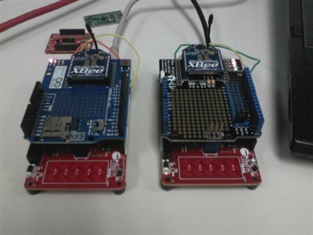

Today’s example demonstrates how to create and receive transmission packets with the XBee modules when they are in API mode. We will set up a network between two Pioneer kits using two Arduino wireless shields and two XBee wireless modules. The following hardware will be used:
  • CY8CKit-042 (x2) Buy Now!Buy Now!
  • Arduino wireless shield board (x2) Buy Now!Buy Now!
  • XBee wireless module (x2) Buy Now!Buy Now!
(Note: in the image above I'm using a different wireless board on the right, Seeedstudio. No changes needed to the example project)

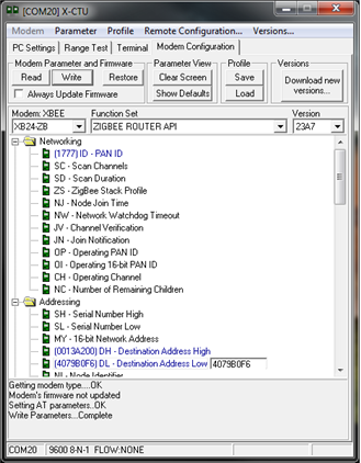

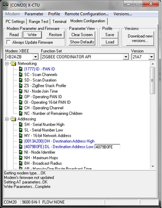

As in examples #024 and #025 we will need to configure both XBee wireless modules for our example. Again I used the sparkfun explorer module and the X-CTU software to perform the configuration. Please follow the configuration examples detailed in examples #024 and #025, with the following settings:
Coordinator Settings (TX) Module:
PAND ID: 1777 (Any address from 0 to FFFF works, must match router)
Destination Address High: 0013A200
Destination Address Low: (Unique address printed below the 0013A200 on the Router module).
Once the information has been entered into the system, click the Write Button in the X-CTU GUI to configure the module.
Router Settings (RX) Module:
Destination Address Low: (Unique address printed below the 0013A200 on the Coordinator module).

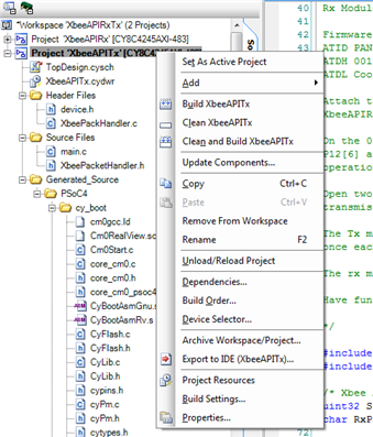

Once the XBee modules have been configured program the respective kits with the correct project. A key point here will be to make sure you are connected to the correct ‘Active Project’. You will notice in the Workspace Explorer window that there are two examples, only one bolded. The bold text indicates the active project. When programming the target Pioneer kit you will need to make sure you have the correct active project selected. You can do this by simply right clicking on the project and setting to ‘Active’.

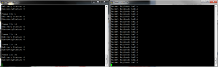

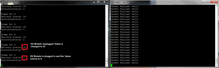

Once the user has connected the TX kit to the hyperterminal software you will see that the TX unit is displaying two values “Delivery Status” and “DiscoveryStatus”. These values are detailed in the “XbeePacketHandler.h” file. The returned value corresponds to a certain state of the radio network. Please review those values for more details.

  1. Two Pioneer Kits
  2. Two Wireless Shields
  3. Two XBee wireless modules
Connect the wireless modules to the wireless shield boards. Then connect the shield board to the Pioneer kits.
Enable the PSoC 4 UART connections to the PSoC 5LP on both Pioneer kits. Using wires make the following connections on each Pioneer kit:
PSoC 4 P4[1] -> P5LP P12[6]
PSoC 4 P4[0] -> P5LP P12[7]

Once you have configured the wireless modules, programmed your PSoC 4s, and connect through the COM port to the Pioneer Board for each kit. You will see the hyperterminal software updating the values every second.
You can see that the ‘Payload’ from the TX kit has been delivered to the RX kit and then displayed on the COM port display from the RX kit.
