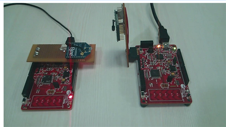

Today’s example demonstrates how to control an RGB LED using the XBee wireless network. In this example the user will be able to scroll through LED colors using the switch, and selecting the brightness using the CapSense controller. The following hardware will be used:

The RGB LED brightness on the CY8CKit-042 (receiver) is controlled using the CapSense slider and user switch of the other CY8CKit-042 (transmitter). The RGB LED color on the receiver changes through a set of different colors when the user presses the switch on the transmitter. A long press on the transmitter switch causes the receiver to automatically change through different colors until a new input is received.
In the video below of the example we are using custom Shield boards. In this example the engineer used two breadboards and soldered a connector and wires to connect the XBee module. Both of these examples use the 6 pin Pmod compatible header (please refer to the kit user guide for more information). In this example we’ve soldered a small header onto the 6 pins to connect the custom board. If you have a wireless shield then simply change the pin selections in the DWR window for both projects.

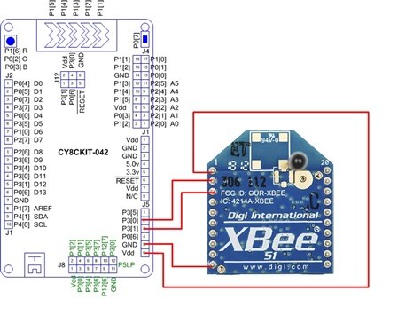

Hardware Connections:
For this example you will need the following hardware:
  1. Two Pioneer Kits
  2. Two Custom Wireless Boards
  3. Two XBee wireless modules
Wire up the XBee wireless modules to the custom protoboard using the following layout. The protoboards linked above might be cut down to save size.

Once you have configured the wireless modules, programmed your PSoC 4s, and connected your wireless modules, begin by pressing the SW2 button on the transmitter board.
Using your finger move across the CapSense slider to change the receiver’s RGB LED brightness.
Hold down the SW2 button to scroll through the LED colors, pressing the SW2 button to stop the scrolling.

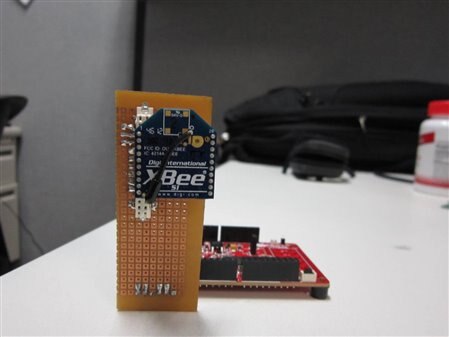

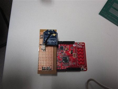

    cy.wbz over 13 years ago +1
    Hello! Here's a couple more images of the custom board. Thanks, Matt
    Hello!
    Thanks,
    Matt
