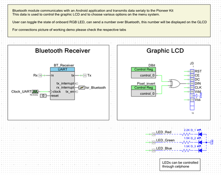

Components Used:
The user can download the example project at the bottom of this post. The project uses the following list of Creator Components:
  • UART
  • Control Registers
  • ISR
  • CyPins
  • CyClock
  • Kit-042 Annotation Library
The components are configured by right clicking on the component in your Top Design schematic view and selecting Configure. Please enable the following selections in the Configuration windows for the listed components above.

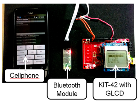

In this example the Pioneer kit uses the Bluetooth module to connect to a Bluetooth network. Once the Pioneer kit is connected to the network the user can enter in characters to the SPP application to control the selections on the GLCD screen. The Bluetooth module communicates to the Pioneer kit using the UART component at 9600 baud. You will be able to navigate through the menu on the GLCD screen using your Android phone.
The GLCD menu selections will allow you to select different RGB LED configurations on the Pioneer kit.

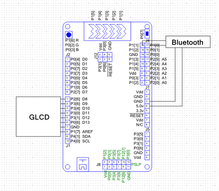

Hardware Connections:
For this example we will be wiring the modules to the Pioneer kit. The GLCD module should be inserted into the J3 header (pins 1-8). The Bluetooth module is connected to pins P1[0], P1[1], GND, and 5.0V.
Test Your Project:
Program the Pioneer kit, start the SPP application and then begin to send command controls to the Pioneer kit to control the GLCD screen.
