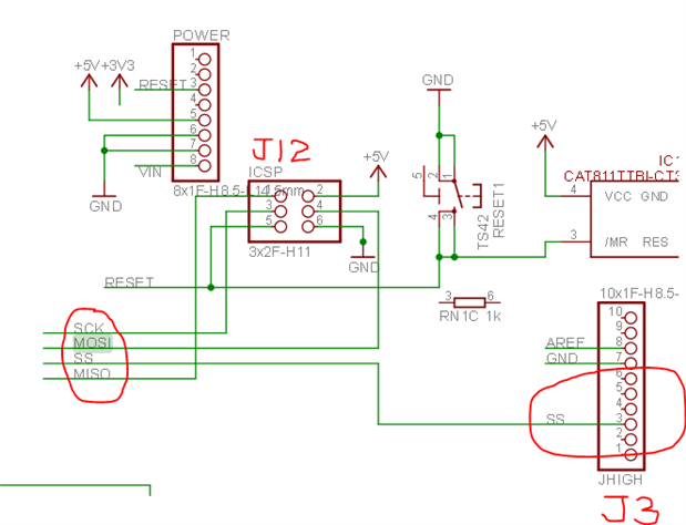

For this example the user will need to populate the six pin J12 header. This header is located near the CapSense slider on the Pioneer board. The Arduino Ethernet shield uses the 6 pin connector for the SPI communications with the WiFi processor. You will need to populate this header to use this shield board.
For more information on the 6 pin header and part number please reference the Pioneer Kit Bill of Materials (BOM) section of the User Guide.
Once the connector is populated then please connect the Ethernet Shield to the Pioneer board. There are no other hardware connections needed.

    Hi,
    Is there a specific reason you decided to use J12 for the SPI bus? It seems like a bit unneeded since you can run through the same port and use J3.
    I'm curious because I looking to drop this shield on some test equipment and I'm fairly through development.
    Thanks!
    e14 Contributor over 10 years ago in reply to e14 Contributor
    Ryan,
    Please refer the schematics of Ethernet Shield Rev 3 at https://www.arduino.cc/en/uploads/Main/arduino-ethernet-shield-06-schematic.pdf
    The SPI lines MOSI, MISO and SCK are connected only to J12 and does not have connection to J3. Hope this answers your concern.
    Thanks,
    Shashikant

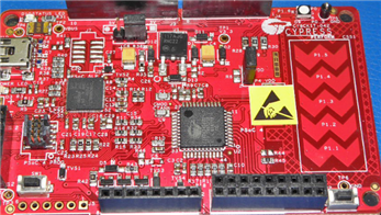

  • riii
    riii over 9 years ago in reply to e14 Contributor
    as I can connect without taking the J12 because my card will not let me, it have not  pines to J12, I attached my card image.
