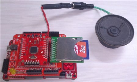

Today we are expanding on the SD card example that we posted last week. In that earlier example we showed you the new customer SD component used to interface with the SD card. In this example we want to expand on that example to play music, stored on the SD card, through a Speaker.
  • PSoC 4 Pioneer Kit
  • Sparkfun Prototype Shield
  • SD Card Breakout Board
  • VS1033D Breakout Board

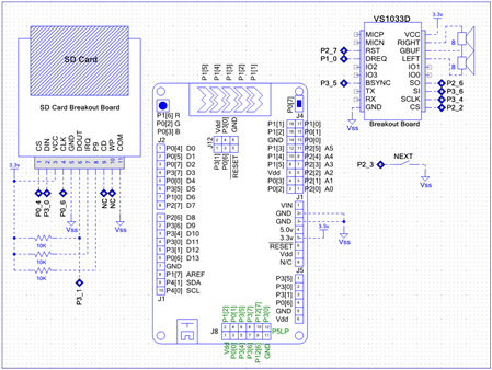

Hardware Connections:
In this example the user will need to connect the SD Card breakout board and MP3 Codec board to the Sparkfun breadboard. This board will then connect into the Pioneer kit. The speaker needs to be wired up to the breadboard and then connected to the MP3 codec board as an output. The following image provides the wiring diagram to enable this design.
Test Your Project:
Program the example into the PSoC 4 kit. The music will play out of the speaker. Use the button on the sparkfun breadboard to switch between songs.
