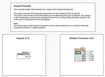

Today’s example is the release of a community component for a 4x4 matrix keypad. At the bottom of this post we have included the example project for the component and the custom component datasheet. The key point of this component is that it’s applicable to PSoC 3/4/5LP device families.

The user can download the example project at the bottom of this post. The project uses the following list of Creator Components:
  • 4x4 Keypad
  • Character LCD
The components are configured by right clicking on the component in your Top Design schematic view and selecting Configure. Please enable the following selections in the Configuration windows for the listed components above.
Firmware Description:
The main.c firmware is included in the example project. Please review the commented sections for more details.

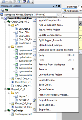

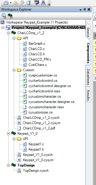

This custom component contains a set of library routines that enable scanning of a 4x4 switch array and return of data associated with the switch pressed. The component provides APIs to implement user defined character data for each switch. This keypad component allows the user to connect signals across multiple points. We have included the component datasheet at the bottom of this post. Remember you can import and export components by clicking on the components tab in the workspace explore. Then right clicking on the project name in the workspace explorer to import or export the compoents.
In this example we take inputs from the 4x4 keypad and then output the values on a Character LCD display.
