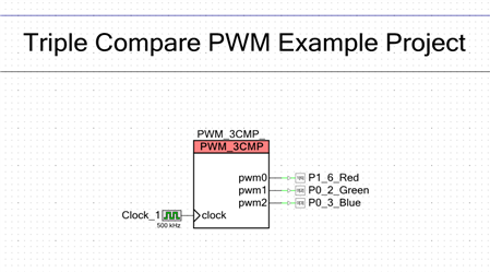

Today’s example plays like one of those late night TV infomercials. First we showed you how to use a PWM with the PSoC 4. We then had an example that showed you how to create two PWM outputs using one PWM. Like in those late night infomercials we say “But wait there’s more”! In today’s example we present a custom component that takes one PWM and creates three outputs.
In this example we create a custom PWM component that performs a triple compare, implements an 8-bit PWM with three separate outputs, and independently configurable values. This custom component uses one Universal Digital Block (UDB) resource to implement the triple output. The component uses one datapath and three macrocells resources. This is very useful since the PSoC 4 device only has four UDB resources and four TCPWM modules. Implementing this PWM will allow the user to save resource space and add more value to their system.

In this example we dive deeper into the guts of what makes a PSoC so unique and useful for engineers. As described earlier we show you the progression of a single output PWM, dual output PWM, and now a triple output PWM. As we increase in complexity we dive deeper into the programmable peripherals of the PSoC.
This custom component allows users to connect three outputs to a single PWM. This is extremely useful when trying to maximize on-chip resources. In our previous examples such as LED Memory and Paint The Night we used three PWM components to drive the RGB LED on the Pioneer kit. This is very wasteful of the UDB and TCPWM resources on the PSoC 4 device. Custom components like the triple PWM will allow users the ability to better manage chip resources and still design the system to meet the design expectations.

Hardware Connections:
There are no hardware connections in this example. Simply map out the PWM outputs to three pins, select your PWM output and connect the output to the RGB LED or connect it to an Oscope to test the ranges of outputs.
Test Your Project:
Program the Pioneer kit with the example and connect the PWM outputs to the RGB LED or to an Oscope to test the PWM capabilities.

    The PWM_3CMP implements a single period-counter, triple compare 8-bit PWM in a single UDB.
