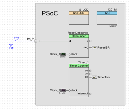

The user can download the example project at the bottom of this post. The project uses the following list of Creator Components:
  • I2C (Master mode)
  • TCPWM
  • CyClock
  • I2C Character LCD
  • Debouncer
  • ISR
  • CyPins

The example projects uses the SCL/SDA pins on the Kit to control the LCD (via the breadboard as the shield doesn’t have a connection to SCL/SDA) and the SW2 on the Kit to control the stopwatch.
Any I2C Character LCD should be possible given the flexibility of the provided component in the catalog.
To setup your LCD, you will need the datasheet to be able to enter the I2C address for the LCD on the General tab of the I2C LCD component.  Unless you are able to locate a NXP PCF2119x LCD, the Command format entry on the customizer should be configured for Custom format, which will enable the fields on the Custom Commands tab.  In that tab, again from the datasheet, you will need to modify the commands to match the byte sequences defined for the device.  You can also specify additional commands (in this example we added the SetContrast and SetBrightness APIs) to control any extra functionality your I2C LCD may have that you wish to utilize.

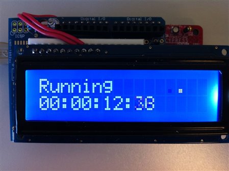

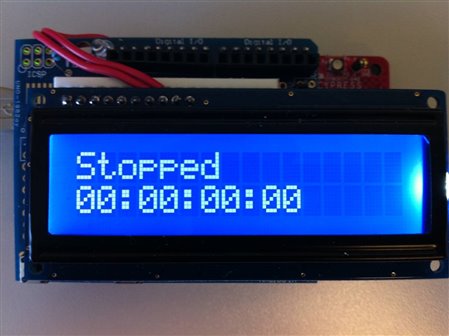

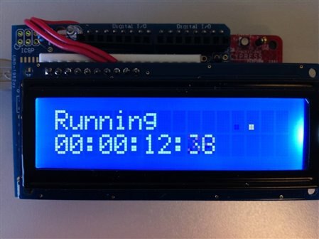

The setup of the firmware will update the display every other millisecond and move the bouncing dot at the top of the display approximately every 33ms.  Pushing SW2 on the kit will clear and start the timer, pushing it again will stop the timer and the animation at the top of the display.
Hardware Connections:
Please connect a simple Breadboarding shield to the Pioneer kit. Then connect the LCD display to the Breadboard. In this example we use the SainSmart prototyping shield.
Test Your Project:
Connect your I2C display and program the Pioneer kit with the example. The setup of the firmware will update the display every other millisecond and move the bouncing dot at the top of the display approximately every 33ms.  Pushing SW2 on the kit will clear and start the timer, pushing it again will stop the timer and the animation at the top of the display.

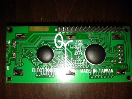

    Thanks for this project. one question the pins p4.0 and p4.1 (SCL/SDA) must be connected to the lcd. Which are the pins numbers in your lcd  to interconnect p4.0 and p4.1?.

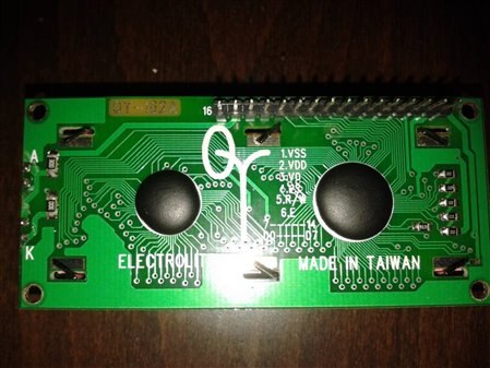

    Thanks for your reply. Yesterday night i try to build this project with an  Electrolite lcd QY 162A, right now i know that i have to buy  another lcd.

    http://www.pongrance.com/dds-lcd.html
    Regards,
    Jesus Antonio.image
    e14 Contributor over 13 years ago in reply to jesusantoniocar
    Hi
    Ah, I see.  That's not an I2C based LCD, but the standard parallel interface type.  You are correct, you would need get a different LCD to work with this project.
