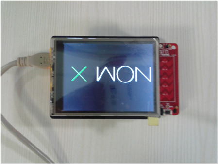

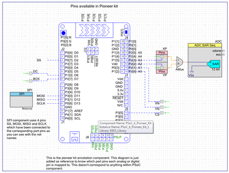

In this example we are showcasing how to interface to the TFT Touch Shield v2.0 with the PSoC 4 Pioneer Kit. This example provides a simple user interface game to demonstrate a resistive touchscreen application with the PSoC 4. This example uses the dedicated Serial Communication Block (SPI) to communicate with the LCD controller. The project does not require any UDB resources, therefore it can be used with the PSoC 4 (42xx and 41xx families).  In this example we will use the CY8CKit-042 Pioneer kit and the CY8C42xx family.

    • Project Schematic
    • Component Configurations

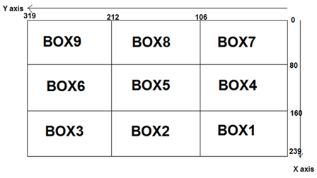

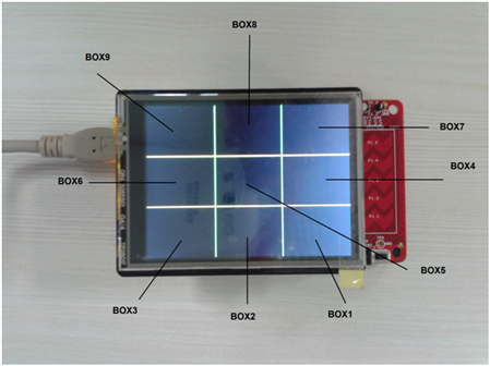

The game screen is divided into nine boxes, BOX1, BOX2, BOX3, BOX4, BOX5, BOX6, BOX7, BOX8, BOX9. These boxes are used to divide the screen and display the X’s and O’s from the user touches. In the project, the analog pins XP, YP, XN, YN and the 12 bit SAR ADC are used to detect if a touch is detected within a box. Once a touch is detected the corresponding analog voltages are passed to ADC. Depending on the thresholds defined for each and every box the ADC outputs will indicate which box was pressed.

Hardware Connections:
In this example the user needs to connect the TFT Touchscreen shield to the PSoC 4 Pioneer kit.

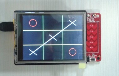

Program the Pioneer kit with the example project and connect the hardware. The user will be presented with squares to place an ‘X’ or a ‘O’. The user can touch the screen to indicate where to place the character. If you connect three characters in a row the game will let you know if you have won.

    I looked at the photo's that you attached and noted the Touch Resource > Pin assignment - the XP and YP were mapped to the wrong ports.
    Do you have an update to your project?
