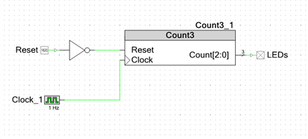

The other week we had a nice series of basic workshop examples  showing the user how to use the PSoC 4 silicon and Pioneer kit. For this next week we will showcase a number of examples and videos that provide training on PSoC Creator.
For the PSoC 3 and PSoC 5LP families we created a number of online training videos to help teach the new user how to use PSoC Creator and develop custom components. We understand there can often be a learning curve when it comes to PSoC Creator and diving deeper into what makes a PSoC so powerful.
For this series we will be posting a number of PSoC Creator training videos. While these training videos may cover the PSoC 3 and PSoC 5LP families we are providing the training video example projects for PSoC 4 devices. These videos focus more on how to use PSoC Creator for more complex example, than the specific silicon. Please feel free to follow the training to recreate the example project.
This example was created to target the CY8CKIT-001 and CY8CKIT-038 processor modules. The example can easily be changed to map to the Pioneer kit by changing the pin selections.

The user can download the example project at the bottom of this post. The project uses the following list of Creator Components:
  • Count3
  • Not Gate
  • CyPins
  • CyClock

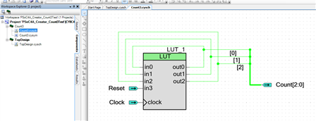

    Hello Matt.
    Thanks for this post.
    i try to follow all steps but when i located the LUT in my design i could not see the clock pin. i dont know what kind of error i am making.
    Best regards,
    Jesus Antonio.
  • cy.wbz
    cy.wbz over 13 years ago in reply to jesusantoniocar
    Jesus,
    If you navigate to the Components tab you can see the underlying schematic layout for the Count3. Here the LUT has a clock input.
    Does this answer your question?
    Thanks,
    Matt

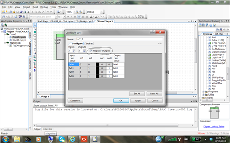

  • jesusantoniocar
    jesusantoniocar over 13 years ago in reply to cy.wbz
    Hello Matt.
    thanks for your fast response.
    i can see my error, when i located the LUT component i need checked the  Box register outputs. by default it is unchecked.
    Thanks.
    Jesus Antonio.image
  • cy.wbz
    Jesus,
    You are correct. When it doubt check out the datasheet (button in the bottom left). I can't remember all of the configurations for each component and I always go to the DS first. I'll be posting another example today diving deeper into custom components.
