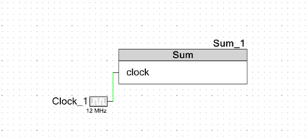

Today we are closing out the last of the UDB and configurable digital training. I'm giving out 3 examples today and three more links to additional training videos. Please feel free to test out the examples and follow along with the training. We will be continuing with more examples and a fun promotion next week.
This example was created to target the CY8CKIT-001 and CY8CKIT-038 processor modules. The example can easily be changed to map to the Pioneer kit by changing the pin selections.
Forum Post Attachments:
  • Example Project Zip File
Components Used:
The user can download the example project at the bottom of this post. The project uses the following list of Creator Components:
  • Sum
  • CyClock
Firmware Description:
The main.c firmware is included in the example project. Please review the commented sections for more details.

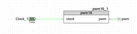

For this series we will be linking the PSoC 4 example below. Please take the time to watch the PSoC Creator training video.
PSoC Creator 212 – Datapath FIFOs
PSoC Creator 213 – Multi-Byte Datapath Components
PSoC Creator 214 – Datapath API Generation
Hardware Connections:
There is no specific hardware connections for this series. We are recreating the training examples for the PSoC 4 family. Feel free to map the pin outs to the Pioneer board to visualize any functionality.
Test Your Project:
Please follow the linked training materials and design your project.
