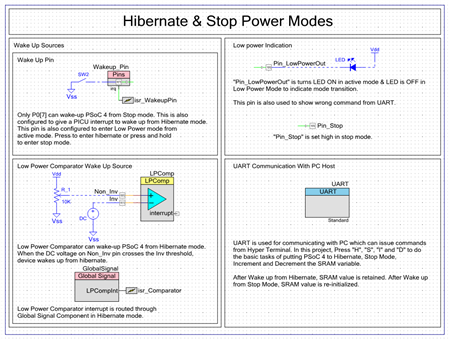

In today’s example we are showing users how they can use the PSoC 4 to enter and wake up from hibernate and stop modes. The example also shows the user how to retain SRAM variables in hibernate mode. The project uses the UART which allows the user to send a command to increment a variable, or enter hibernate and stop low power modes. Hibernate and Stop modes can also be entered using the same switch during active mode.

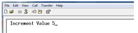

The example will accept a set of UART commands to perform actions:
  • ‘I’ – Increments the SRAM variable
  • ‘D’ – Decrements the SRAM variable
  • ‘H’ – Enters Hibernate power mode
  • ‘S’ – Enters Stop mode
The SRAM variable retains its value when it wakes up from hibernate mode and is reset when the device wakes up from Stop mode.

The Lower Power Comparator interrupts are used as wakeup sources to bring back the device from hibernate mode. The dedicated wake-up pin P0.7 is used as a wake-up source to bring back the device from stop mode.

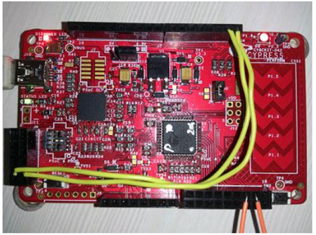

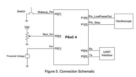

Hardware Connections:
In this example we will need to connect our UART pins from the PSoC 4 P0.4 and P0.5 to the PSoC 5LP P12.6 and P12.7 pins.
Connect the DC voltage to the inverting terminal of the Low Power Comparator P0.1.
Connect P1.5 to an oscope.

Program the board and launch the hyperterminal application and begin communicating with the PSoC 4. Use the comparator and push button inputs to control the power modes.

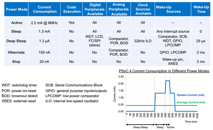

  • cy.gul
    cy.gul over 13 years ago
    Precisely! With its multiple low-power modes and the different hardware resources available in those modes, PSoC 4 gives the designer very fine control over resource usage and optimization.
    What's impressive are the 20 nA Stop mode (non-retention) and 150 nA Hibernate mode (with retention). In the Hibernate modes, you have low-power comparators that can still be active, and GPIO that can retain their states as well.
    Here's a quick overview of PSoC 4's power modes, for full details please refer to the device datasheet.
