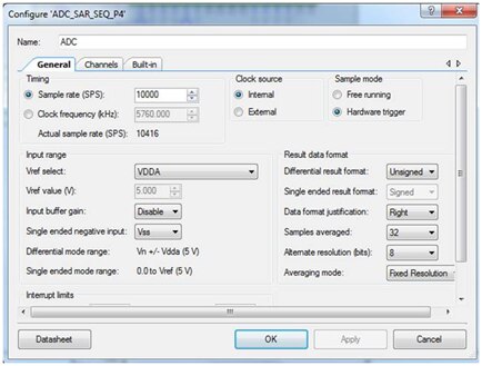

Let us now take a look at the project.  Figure below shows the schematic of the project.
Place an OpAmp configured as a buffer.  Place an analog input pin and connect this pin to the input of the buffer.  Assign P1[7] to this pin.  Place an ADC and configure the ADC for a reference of VDDA (we will dynamically change this in code).  Select the Single Ended Negative Input to VSSA.
Following firmware will now take care of the VDD measurement.  The result is availabe in the variable "Vdd" in millivolts.
