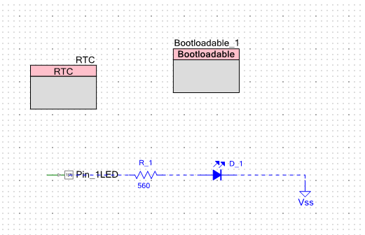

Hello
I am new here, I hope someone will guide me I have psoc 4 device   I am doing experiment with LED. I have LED on psoc 4.  LED is connected port P1[7].  I am trying to set alarm for LED using RTC
(D/M/Y     H/M/S)
LED will turn on for 5 second on date 22/5/2015  time 5:50:10
LED will turn on fo 10 minute on date 23/5/2015   time 5:50:10
LED will turn on for 5 hours on date 24 /5/2015      time 5:50:10
I am attaching project workspace. I am getting problem in program

    I do not see where the Pin gets setup to trigger the LED. Your code looks incomplete. Why are the interrups disablled? You need them if you expect to do something on the alarm from the RTC.
    Clem
    PS. I would try things in steps. First See if you can blink the LED without RTC.

    vead11 over 11 years ago in reply to clem57
    Hello Clem
    I have done LED blinking project without RTC
    look at this attachment
    my code is incomplete. I need help to complete code
