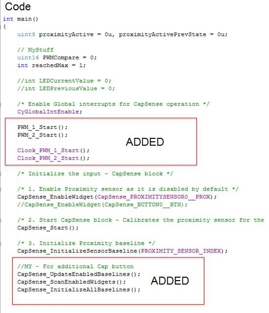

Hi,
I am using the CY8CKIT-043CY8CKIT-043 PSoCRegistered 4 M-Series Prototyping Kit. What I am trying to achieve is to be able to detect the proximity of a hand and at the same time been able to interact with capacitive buttons.
Getting the proximity part of the project works fine, but been able to turn on and LED by pushing on a CAP sense button does not. I have looked thru the examples and tried different options to get the LED to turn on but to not end.
My first question is can you use both the proximity feature and the cap sense button at the same time?
I appreciate the feedback. Thanks.

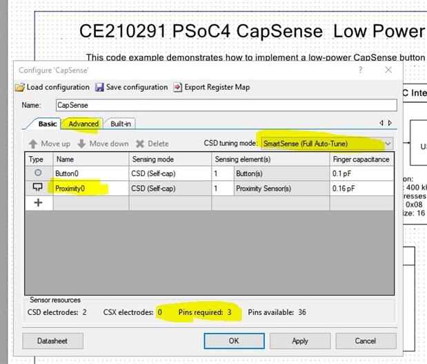

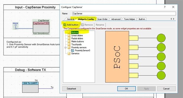

    Well it all starts in the "TopDesign" screen and it is probably easier to modify an example that works for you.

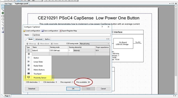

    Depending on which example you choose to work from, i.e. Proximity or CE210291 Button, you may see slight differences with the component you see on this screen. Could be either a CapSenseCSD component (found in my proximity example) or a CapSense component (found in Button example). Basically they are one and the same.
    In CapSenseCSD you can add in a button as follows:
    In Capsense it will be as follows.... I note in my example they used manual tuning. You would probably need to change this to auto tune for proximity part and if so you also need to change the modulator clock frequency (found in Advanced tab and CSD settings).

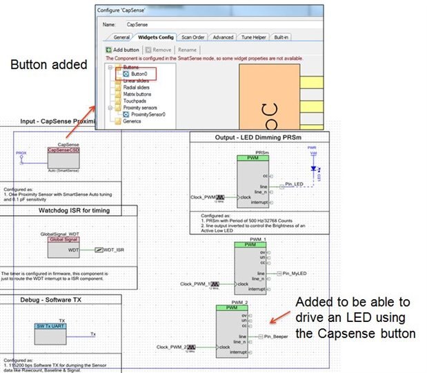

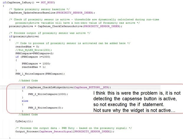

    Hi BigG,

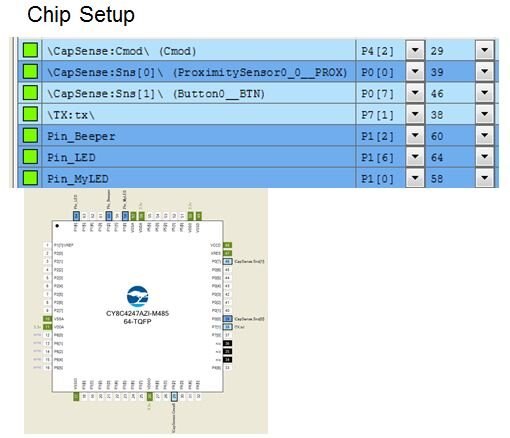

    Yes I was able to add the button as you mentioned. Below you can see some picts showing where I am at and where I think the issue is. Hopefully you can spot what is causing this to hang up.

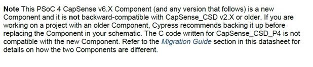

    The CapsenseCSD component as found in that example and which you are using is actually an older version of the component. Cypress documentation from the newer Capsense component recommends the following:

    Hi,
    The project is working now. In my program I was missing a couple of declaration that would enable the button sensor. Cypress team pointed out the issue.
    I had to add the following before the for loop:
        CapSense_EnableWidget(CapSense_BUTTON0__BTN);
        CapSense_InitializeSensorBaseline(CapSense_SENSOR_BUTTON0__BTN);
    and CapSense_ScanEnabledWidgets(); to make sure the button widget gets scanned.
    Thank you for your support on this!
