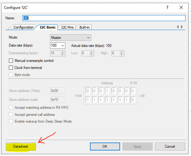

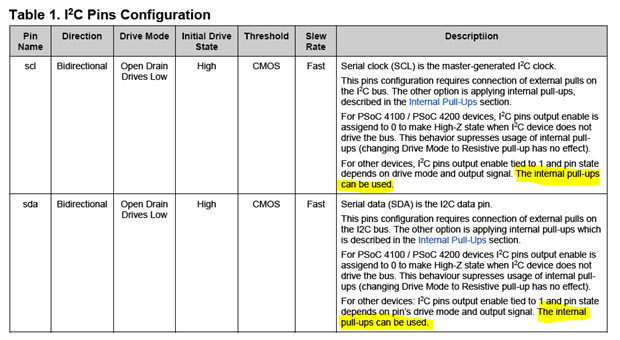

  • BigG
    0 BigG over 6 years ago
    I'm assuming you wish to use internal pullups.
    To learn how to configure those, go to the I2C block in your "TopDesign" page and open up the datasheet. This provides you with all the info you need.
    Find table 1, as this summarises configuring the pins.
    Then to configure internal pullups just find the "Internal Pullups" section in the datasheet.
    Within this section it basically tells you to...
    Add the following code before starting the Component (with SCB_Start()) - don't forget to change "SCB" part to match same name as your I2C block. In my case my block name was simply "I2C".
    /* Change SCL and SDA pins drive mode to Resistive Pull Up */
    SCB_scl_SetDriveMode(SCB_scl_DM_RES_UP);
    SCB_sda_SetDriveMode(SCB_sda_DM_RES_UP);
    (also don't forget to check that the "slew rate" properly matches clock speed as this caused problems with me once before).
    Hope that helps.
