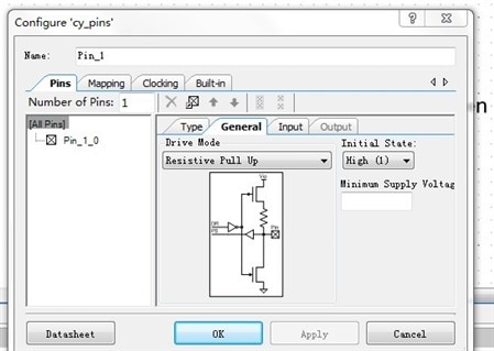

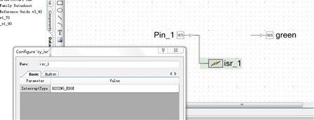

I just wanna test the interrupt of psoc4, using CY8CKIT.
After power up, and pressed the button,it entered the int handler but it stucked in the handler and can't back to main()...

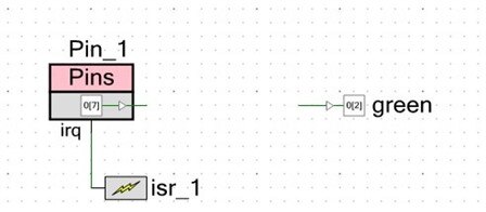

A falling edge of button pin will cause an interrupt,

    Do not use delay in interrupt routine.
    If you complete interrupt process, exit the routine as immediately.
    When using Pins module,
    you might be need Pin_ClearInterrupt() ;
    It may depend on PSoC device.

    hi~~thank you~
    i gotta it solved.
    The problem happened in the pin configuration. I canceled the pin interrupt and use isr_1_SetPending(); in the main function to call the interrupt function.It got work,and exit the interrupt function successfully.
    Next , I canceled the pin's interrupt and set interrupt in isr_1. Button pressed ,It got work.
    So the problem must be in the pin configuration. But I still don't know...
