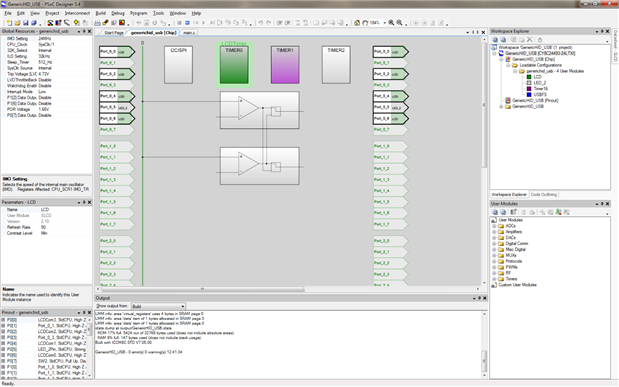

In the example released today we will show the user how to create the simplest of USB projects. In this example we will be using the USB-HID driver provided across OS platforms. In this example we will take the example in project #4 (linked below) and expand to incorporate a GUI that reads data and controls features on the kit. In this example we have provided example code for GUIs running on Windows, Mac, and Linux machines. In the images below we show the windows based GUI.

User Modules Used:
The user can download the example project at the bottom of this post. The project uses the following list of Creator Components:
  • USBFS
  • LCD
  • LED
  • Timer16

In this example we have created a simple USB device, using the HID driver, that can be used to shuttle generic data base and forth between a computer and the PSoC over the USB drive.
In the example we define two data buffers for the USB communication, one for the data inputs and outputs. The data is processed in two separate functions, Process_EP1() and Process_EP2(). The Process_ES1() function includes the value read from the timer and the current status of the push button connected to SW2. The function updates the data buffer and is continuously called from the main function. The Process_ES2 function reads the user’s inputs into the GUI window and updates both the LED state and PWM Duty Cycle value.
