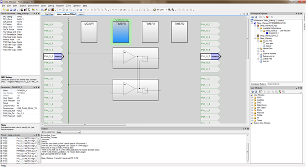

In the example released today we will show the user how to create a project that demonstrates the sleep functionality of the CY8C24x93 devices. In this example we will control the device’s power state using a push button and indicating sleep vs. active state using a blinking LED. This project is similar to our earlier example in project #1, but incorporates the sleep mode

  • PWM8SW
Firmware Description:
The main.c firmware is included in the example project. Please review the commented sections for more details.
In the example code the CY8C24x93 device uses a PWM8SW User Module to blink and LED at 1Hz. When the switch (SW2) is pressed, the device enters sleep mode and the LED stops blinking. If switch (SW2) is pressed again, then the device wakes up and the LED starts blinking again.
Hardware Connections:

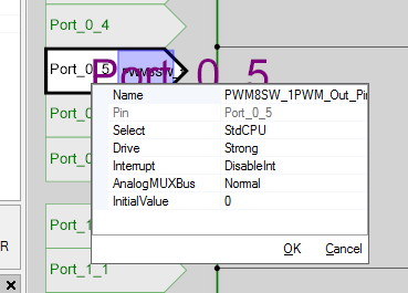

There are no hardware configurations for this example. The PWM output is set to the pin (P0.5) that is connected to the LED and the switch (SW2) is connected to the device (P0.7).

Build the project and program the PSoC 1 device using the program button in PSoC Designer, Program>Program Part. Begin to push the SW2 button and see that the LED blinks and then stops blinking.
