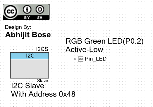

Here is the Application Schematics:
In this example we use the SCB based I2C Slave module to perform communication Via the PSoC 4 Pioneer Kit Bridge Interface.
This is done internally on the Kit as the PSoC5 is connected to the pins P3.0 and P3.1 with I2C Pull-ups to the PSoC4.
Hence no external circuitry in required.

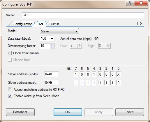

The settings for the I2C Slave module { I2C (SCB mode) [v1.10] } is as follows:
Apart from the I2C Slave we also use a Single pin LED connection for the Green color in the RGB LED P0.2 as shown in the earlier examples.
Now for the source code we plan to have engage the Deep Sleep mode for the PSoC4 when the I2C Slave is not busy.
This is achieved by activating the 'Enable wakeup from Sleep Mode' option in the I2C module and applying proper API sleep for I2C module.

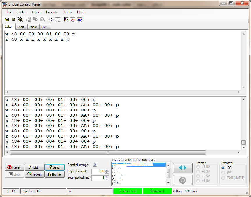

After successfully building and loading this code the Cypress Bridge Control Panel needs to be used.
Here is the Settings for the Bridge Control Panel:
The two commands used to subsequently Write and Read the I2C data are as follows:
w 48 00 00 00 01 00 00 p
r 48 x x x x x x x x p
These commands need be entered in to the Editor plane of the Bridge Control Panel. In order to go to Next line use Ctrl + Enter in the Edition pane of the Bridge Control Panel.
Also make shire that the 'Send all Strings' check-box is selected as ON.
Here is a snapshot of the Communications:
