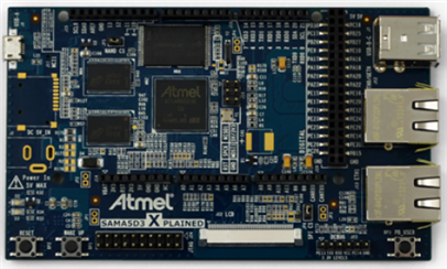

Boot Debian from an SD Card on the SAMA5D3 Xplained
cstanton
cstanton
25 Apr 2014
So when I wanted to build a version of Linux for the SAMA5D3 board that wasn't Yocto or a demonstration image, then I started to struggle to find solutions.image
Here I present the steps I took to have Debian working on the SAMA5D3, I also have a .IMG of the SD Card I created available.
I set this up using a laptop with Debian Linux installed; I imagine it doesn't matter which version of Linux you have; you could probably use Cygwin on windows.
You will need:
  • An SD card (I tend to work with at least a Class 6, 8GByte)
  • An Atmel SAMA5D3Atmel SAMA5D3 board with a Micro-A to USB-A cable (should come with the board)
  • A computer with Linux (unless you're able to translate the steps to Windows, feel free) with an internet connection
  • An FTDI 3v3 TTL type cableFTDI 3v3 TTL type cable
I built the SAMA5D3 image on an installation of Debian Wheezy, 64bit. Because the pre-compiled GCC compiler is 32bit you need to have the i386 architecture added and some packages installed (you'll have to find the relevant equivalent for your Linux distribution):

Our SD Card should be setup! The only thing to do now, is remove the jumper at JP5 on the SAMA5D3 to ensure it'll boot from the SD Card, connect a serial cable to the debug header J23 so we can see what it's doing, with the settings in minicom/Putty/your terminal editor of choice:
    Baud:        115200
    Data Bits:    8
    Stop Bits:    1
    Parity:        None
    Flow Control:    None
Then connect the USB cable to power the board, then press the reset button for good measure and watch it boot up!
