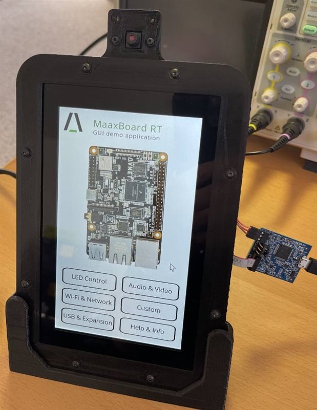

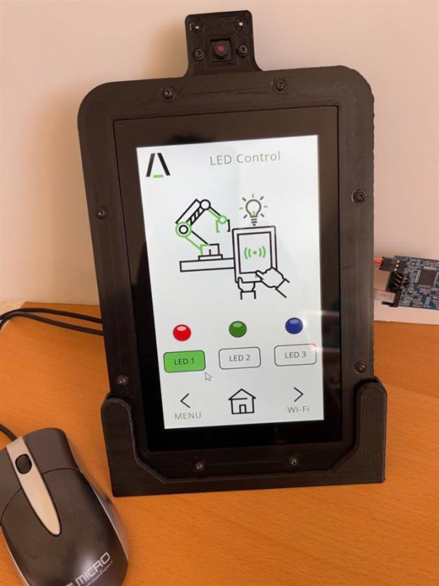

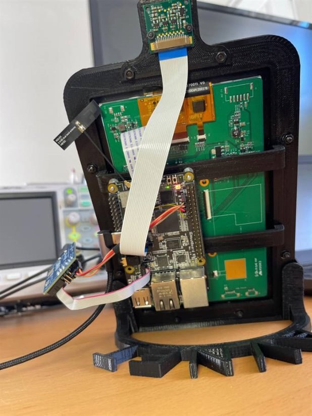

I recently designed a frame and stand for the Avnet MaaXBoard MIPI LCD touch display
There were 3 main design goals . . .
  1. Provide some level of protection for the LCD display
    1. Frame can lay with the screen down and screen will not touch surface
  2. Provide stands for both portrait and landscape modes
    1. Frame can be lifted from stand
  3. Provide optional MaaXBoard MIPI CSI Camera mounts (one for each orientation)

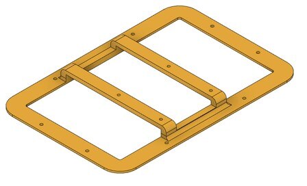

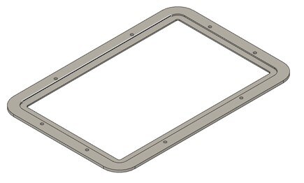

Parts to Print

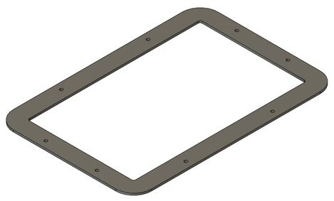

  • Front Bezel (Required for all assemblies)
    • Use M3 screws and nuts to capture display between front and back bezels
  • Back Bezel Board Mount (option 1 of 2)
    • Includes a mount for the MaaXBoard
    • Insert low profile M3 screws from the LCD side of the MaaXBoard mount and use nuts to hold the MaaXBoard to the mount
    • When printing use supports under mounting frames
  • Back Bezel (Option 2 of 2)
    • Does not include a mount for the MaaXBoard
  • Camera Mount Landscape (optional)
    • Uses screw holes from bezels to mount
    • Mount camera from behind mount
    • Use 1-72 NF screws and nuts to mount camera module to mount
    • Can mount to either side of the frame
  • Camera Mount Portrait (optional)

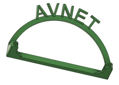

  • Stand Portrait (optional)
    • Print with Avnet text on print bed
    • No supports required

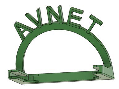

  • Stand Landscape (optional)
