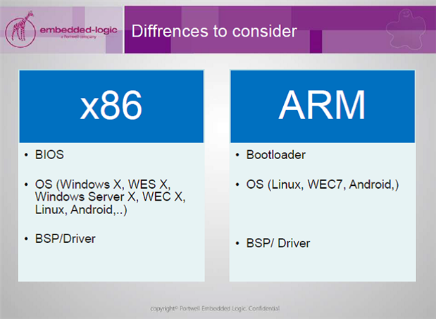

  1. Fig. 1 Key differences of x86 vs. ARM (note: BSP is board support package, an implementation of specific support code—software-- for a given board that conforms to a given operating system. It is commonly built with a bootloader. In embedded systems BSP is system and device drivers for all the devices on the board. (Source: embedded-logic)
As for run-time stability (uptime without crashes), which can be a key deciding factor, no clear cut winner here: Both ARM and x86 processors are relatively well suited to be used in industrial and other embedded systems that require stable, reliable and deterministic run-time behavior.

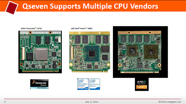

The new Qseven specification update 2.0 allows using x86 and ARM processors on Qseven modules and can accommodate the  new Intel E38xx Atom processors as well as such ARM processors as the Freescale ARM i.MX6 (both supporting a wide variety of I/O features). The new USB 3.0 and UART additions are widening the scope of this module family even further. The devices’ strong graphics performance can be used to drive HDMI, DVI, DisplayPort and LVDS displays. For example, the Qseven module with Intel Atom E38xx enables dual independent display while the Q7-IMX6 even supports triple independent display, a feature formerly limited to high-end computer boards. The majority of customers are either using Qseven for x86 or Qseven for ARM exclusively; however, there some that are moving in both directions.
Figure 2 Qseven supports ARM (represented in this case by Freescale), Intel and AMD processors (Source: Congatec)

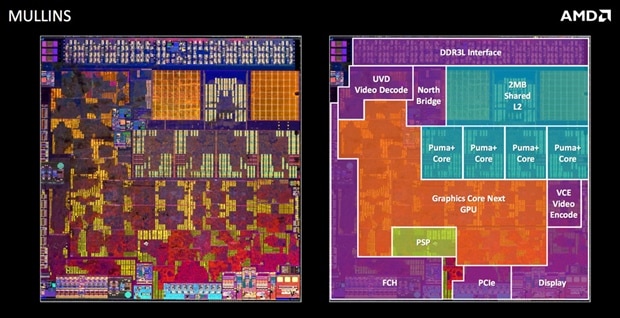

Adding to what is already a recipe for brain freeze AMD has announced it will develop processors, code named Mullins and Beema, which will consist of AMD’s next generation x86-based core, with an ARM-based core for handling security functions on the same SoC.
Figure 3 AMD’s Mullins processor (Source: AMD).
At the same time in parallel with the company’s next-generation of x86 processors, AMD plans to develop its own 64-bit ARM-based CPUs, code named “Project SkyBridge.” targeting embedded applications. SkyBridge’s ARM-based unit will use low-power 64-bit ARM Cortex-57 cores, while the x86-based chips will feature AMD’s next-gen Puma+ central processor cores. The clever bit is that the chips will be “pin-compatible,” meaning they can both use the same circuit board, simplifying things (somewhat) for device makers. SkyBridge chips will be manufactured on a next-generation 20nm process and ship sometime in 2015.
