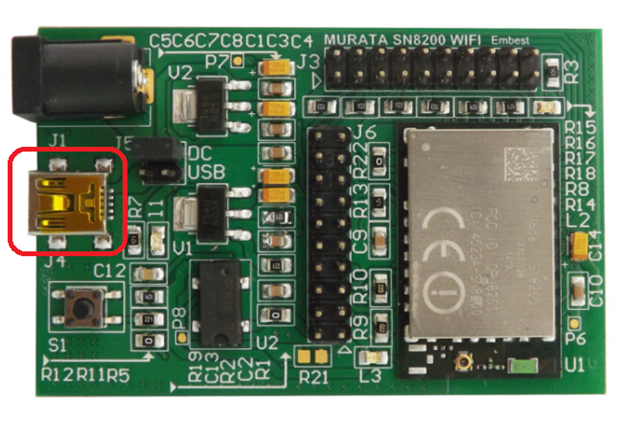

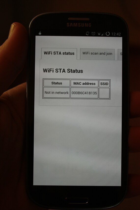

The STM32F4 Discovery WiFi board's default behavior is to act as a wireless access point. Since this is the case, we can test out the WiFi board and make sure that it is working correctly before we attach it to the STM32F4 board. Less variables means less things to potentially go wrong. So, we'll start out by using this default behavior to connect to it and do some initial configuration. In doing this, we will verify that WiFi board is working as expected and that we can connect to a wireless network.
The first step is to power the device. The easiest way to do this is to plug in a mini-USB cable into the board:
Once you do that, the LED next to V1 should light up red indicating that there is power to the board. Now, since the board starts up as a wireless access point, we can connect to it with any WiFi device. Since, I had my smart phone handy, that's what I used.

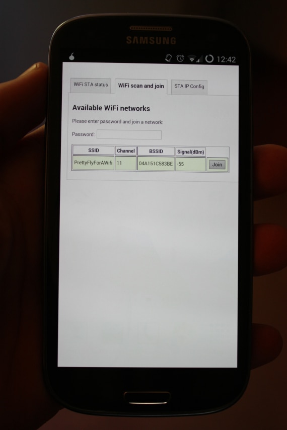

Start by searching for WiFi networks and look for one that starts with “Murata-WS”. For me, it was called “Murata-WS-418135”. After you connect to that network, then open up a browser and navigate to sn8200.com. This will present you with a page that looks like this:
Select the second tab called “WiFi scan and join”, and you will get a web page that lists all of the available networks:
Navigating the UI should be pretty straight forward. Enter in a password, if your network has one – and it should, then click join. You will get a message like “Result: Join pending. Allow 10 seconds for the status to refresh”. After waiting 10 seconds (or so) click OK and then navigate back to the initial tab “WiFi STA Status”. On this page you should now see a Status of “In network”, and the SSID should be populated with the SSID from your network.

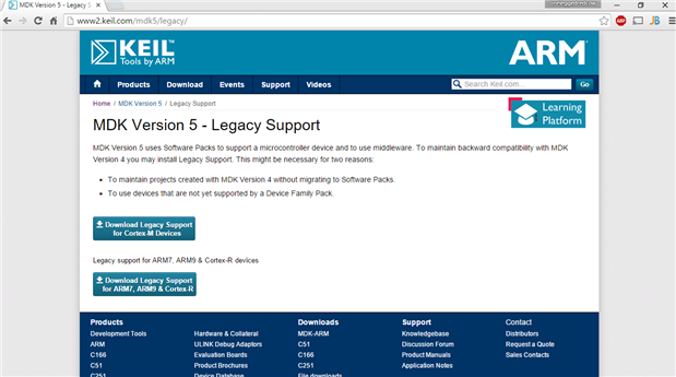

Now the latest Keil IDE is on version 5 and the example code was created on version 4, so you will have to convert the project upon opening it. During the conversion, it will ask if you would like to install legacy support, which you do want to install. It will automatically take you to:
http://www2.keil.com/mdk5/legacy/
Download and install the first option: “Cortex M Devices”.

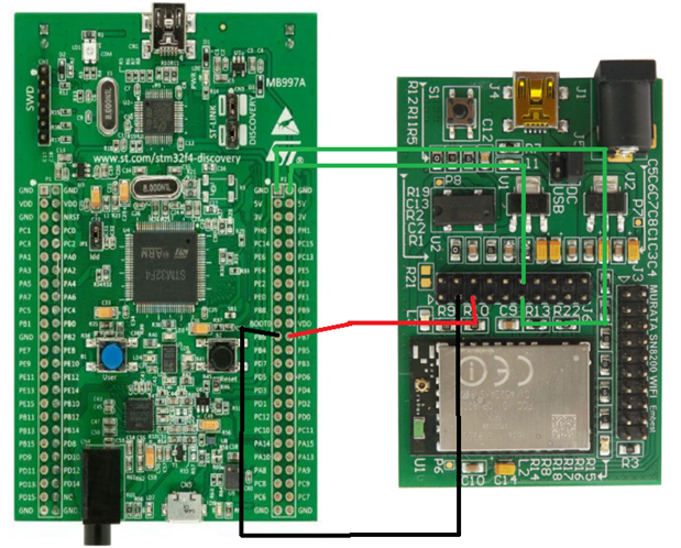

Now that we got the sample code compiling, it is time to get it up and running on the STM32F4 Discovery device. To do this, we need to wire together the STM32F4 Discovery board to the STM32F4 Discovery WiFi board, and then we need to connect the STM32F4 Discovery board to our PC so that we can see what is running on the board.
First, let's wire together the two boards. To do this, make the following connections:
STM32F4 BoardWiFi Board
PB6
J6 - pin 3
PB7J6 - pin 5
GNDJ6 - pin 11
GNDJ6 - pin 12
The we also need to connect the  UART8000-UUART8000-U cable to the STM32F4 Discovery Board and the computer The USB end goes into the computer that's pretty easy The other connections look like this

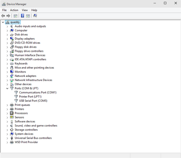

Nice, once that is connected, and the USB end is plugged into your computer, open up Device Manager (Start – Control Panel – System and Security – System – Device Manager). In there you should see a section called ports, expand that and in there you should see your STM32F4 board.
Now, the name does not make it obvious what it actually is; it is called “USB Serial Port (COM5)”. If you are unsure which entry is your STM32F4 board, one simple way to figure it out is to unplug and then reinsert the USB into your PC. Removing it should cause the Device Manager to refresh and whatever one went away when you unplugged it and then came back when you plugged it back in is your STM32F4.
Now, the important piece of information is the COM port that the STM32F4 board is connected to. In my case this is COM5. With this information, we can connect to the board using putty.

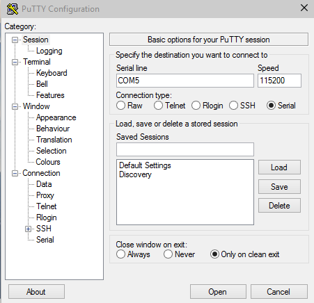

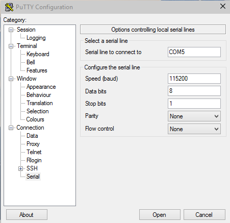

Fire up putty and start by going to the Connection – Serial settings page. On that page, make the settings look like this:
You'll want to change the entry from COM5 to whatever COM port that your STM32F4 is connected to. However, the Speed (baud), Data bits, Stop bits, Parity and Flow control settings should be changed to match the picture above.
Once those settings are complete, go to the Session page and choose a connection type of Serial. This should pull in the settings that we configured in the previous step:
Optional: Now it is probably a good idea to name the session and save it. To do this, add a name in the Saved Sessions text box and click Save. This way you don't have to reconfigure the Connection – Serial settings every time that you open up putty.
Once everything is set up, click the open button. This will open up a terminal to the STM32F4 Discovery board. Now, at first this will come up blank. In order to get it to do something more exciting, we need to load the WiFi demo program that we compiled earlier on to the board. To do this, open up the Keil IDE and click on the load button:

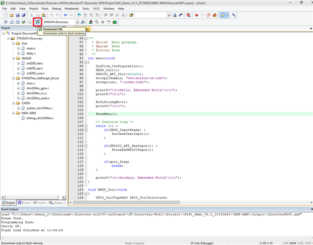

In the Build Output window you can watch the progress of the program getting loaded on to the board. When it is complete, you should see a message like “Programming Done. Verify OK.”

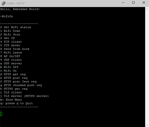

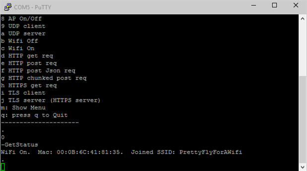

Once this is complete, if you go back to your putty window, you should see a new menu appear:
As you can see, the demo application has quite a bit of functionality in it! As a test to make sure that everything is working like we expect it to, type in a 0 to Get WiFi status. This should return a message like this:
Awesome, this returned the information about the network that we connected to in the previous section. Now we can be confident that the boards are properly wired together and that we can successfully connect to a network.

4) Open the <WiFi>/software/ST-Discovery-Wifi/Project/WiFi_Demo_V2.2_20130620/MDK-ARM/DiscoverWIFI.uvproj within the Keil IDE.
5) Right click on the User folder and choose the option “Add Existing Files to Group: 'User'...” and then within the file dialog, select the following files: stm32f4xx_it.c, tm_stm32f4_delay.c, tm_stm32f4_disco.c, tm_stm32f4_gpio.c, tm_stm32f4_lis302dl_lis3dsh.c, and tm_stm32f4_spi.c
6) Right click on the STM32F4xx_StdPeriph_Driver floder and choose the option “Add Existing Files to Group: 'STM32F4xx_StdPeriph_Driver'...” and within the file dialog, select the following file: stm32f4xx_spi.h
7) Replace all instances of mdelay with Delayms
8) In main.c and sn8200_api.c change #include “delay.h” to #include “tm_stm32f4_delay.h”
9) In tm_stm32f4_delay.c add:
10) Right click on folder STM32F4-Discovery and choose “Options for Target 'STM32F4-Discovery'...”. Within the C/C++ tab, there should be a section called Preprocessor Symbols, and within there a text box labeled as “Define:”. Add KEIL_IDE,TM_DISCO_STM32F4_DISCOVERY to the end of the list.
Now you should be able to successfully compile the program and run it. This should produce a program that has the same behavior as the accelerometer program, but has some additional libraries included so that we can add some WiFi behavior when the time comes.
