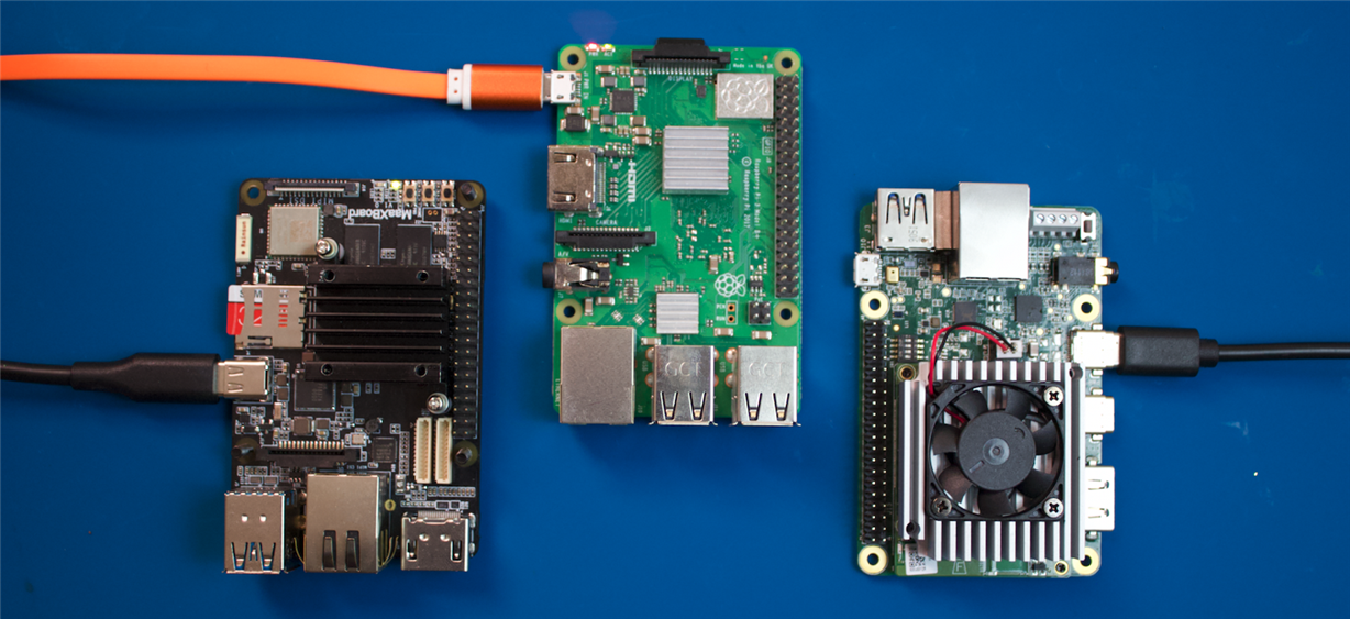

I wanted to compare the MaaXBoard to two of the boards I thought were its closest competitors:
1. The beloved Raspberry Pi model 3 B+, which is cheap, has great versatility and wonderful documentation and a thriving community
2. The Google Coral, which is more expensive but is currently state of the art for machine learning on the edge

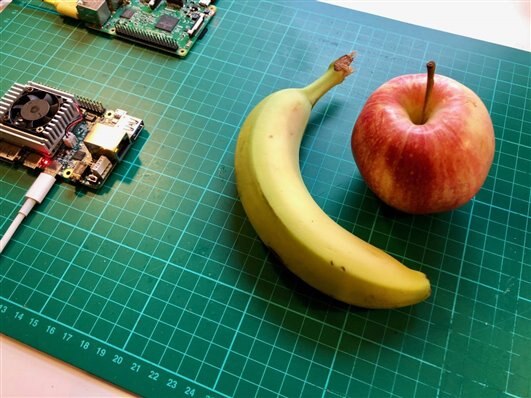

The image
I decided to use the exact same image that Alasdair took of an apple and a banana so that I would be able to easily compare these benchmarks to last year's benchmarks.

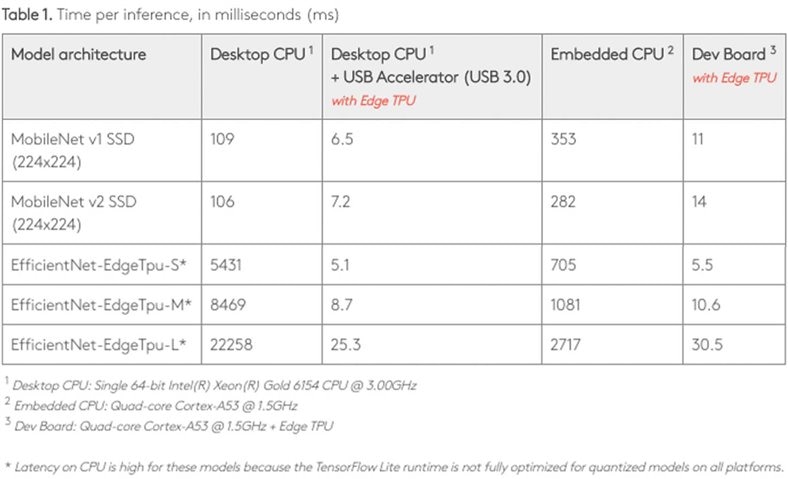

Coincidentally, there are some basic benchmarks available for the exact same models I'm using benchmarked on the Coral Dev Board, an embedded CPU, and a desktop CPU. I actually didn't find these until after I had already performed the benchmark, which is why I was so surprised by EfficentNet-Lites's performance on the MaaXBoard and Raspberry Pi.
One really interesting thing to note is how much changing the image size slows down inference for EffiientNet-Lite. EfficientNet-EdgeTPU-S runs on 224px square images, EfficientNet-EdgeTPU-M runs on 240px square images, and EfficientNet-EdgeTPU-L runs on 300px square images. Based on these results, it looks like for every ~20 pixels you add to your input image size, you almost double the inference time. The reason to use larger images is for greater accuracy, so this is another tradeoff.

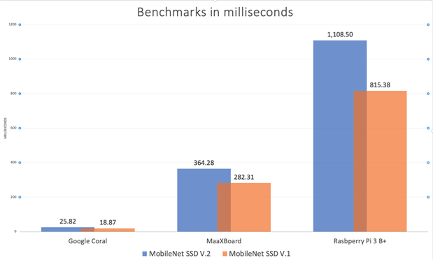

MY RESULTS
Performance is measured in milliseconds.
ModelGoogle CoralMaaXBoardRaspberry Pi
MobileNet SSD V.225.82 ms364.28 ms
1108.5 ms
MobileNet SSD V.118.87 ms282.31 ms815.38 ms
EfficientNet edgetpu L35.04 ms3342.87 ms8143.91 ms
EfficientNet lite0180.29 ms365.29 ms637.52 ms
As you can see, the Coral Devboard is also the fastest by a large margin, MaaXBoard is in the middle, while Raspberry Pi is quite a bit slower.

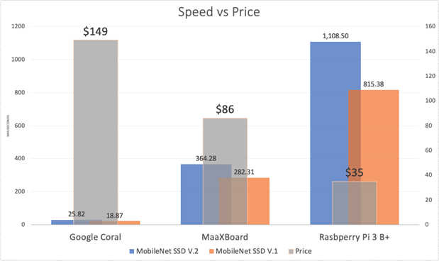

Speed vs Price
Not surprisingly, the speeds reflect the prices - I guess you get what you pay for. Here are the prices for each board overlaid on the speed of MobileNet inference:

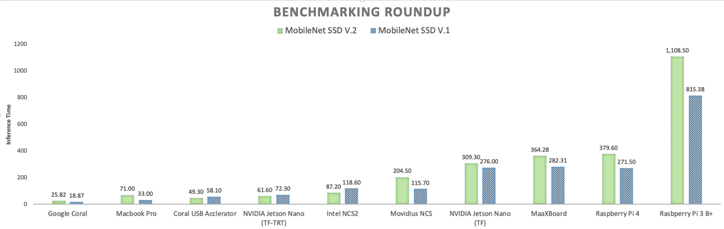

How does the MaaXBoard stack up to other hardware? Well, the good thing is we have data from Alasdair's Tensorflow Lite benchmarks, so we can compare it to eight different platforms:

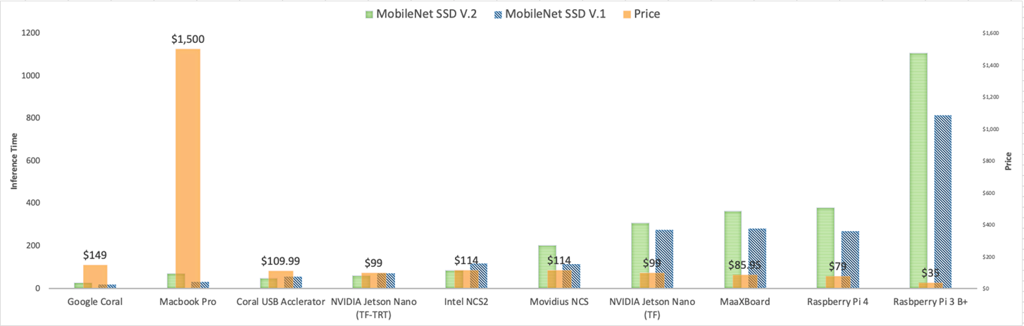

Here are the benchmarks again, this time with the hardware cost overlaid:

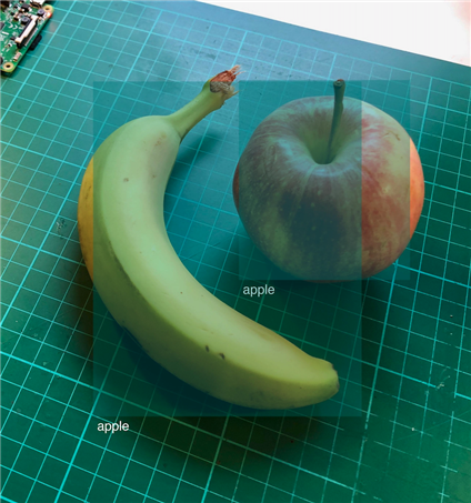

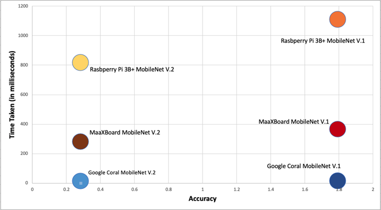

Accuracy for MobileNet Image Detection
MobileNet didn't predict correctly every time, especially for v.2. Sometimes it thought the banana was also an apple.
This chart maps accuracy vs speed. I measured the "accuracy" of image detection by summing the confidence of the prediction times the correctness of the prediction (1 for correct, -1 for incorrect). As you can see, there's not a lot of correlation between accuracy and speed. The main indicator of accuracy is the model itself, and the main indicator of speed is the hardware it is run on.
Getting a single measurement of accuracy for EfficientNet-Lite is more difficult, since it's a classification model that provides a list of possible labels and there's no binary "correct" or "incorrect." Using the same image of the apple and the banana, EfficientNet's guesses varied wildly, from "screwdriver" to "hook, claw." And yes, banana is in the data set. Apparently "apple" is not however - instead they have a "custard apple" and I'm not even sure what that is.
Running the inference on an image of Admiral Grace Hopper produced much more consistent results. EfficientNet recognized her military uniform every time.
