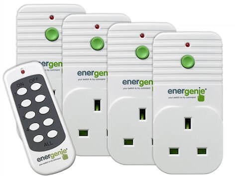

There is a remote power control solutionremote power control solution for home use by a company called Energenie, that provides radio-controlled mains socket adapters for UK use. These are intended for use with small radio-controlled handset, like a TV remote; I wanted the ability to use them with any microcontroller board. This is a short post about my findings. The aim was to control these sockets:
with this:

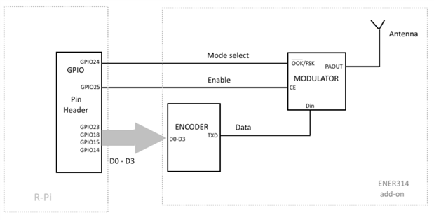

The first step was to take a look at the Energenie documentation (PDF). They provided a lot of information; clearly the documentation is written by an engineer. It is great to see the level of openness. This is the block diagram from their documentation:

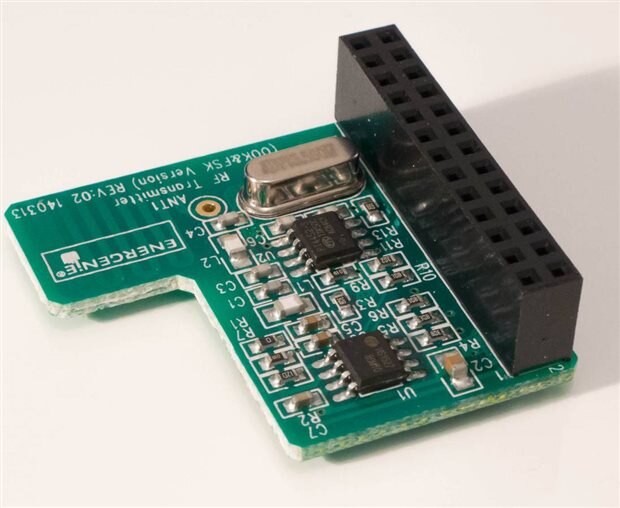

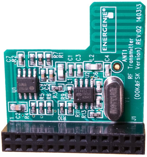

The next step was to look at the hardware. Here is a photo of the board:

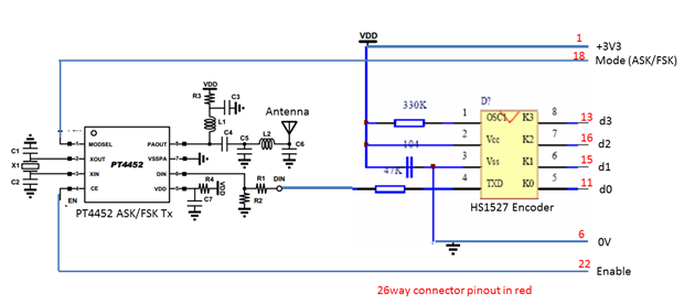

Out of curiousity the circuit was examined briefly. There are two ICs on the board, and the datasheets are available on the Internet. An approximate circuit diagram from the two datasheets was created below; the left side shows the transmitter (containing a PLL locked to a fixed multiple of the crystal frequency – i.e. just a single channel), and the right side shows an encoder device to generate a stream of data. As can be seen, it is basic (but sometimes this is all that is required). It is better than some circuits which rely on lower-cost transmitters without a PLL to shave some cost. The dual-mode (ASK/FSK) capability is also nice.

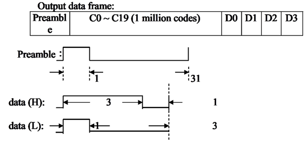

The encoder has some values d0..4 brought out as signals as shown in the circuit above, but also some signals c0..19 are internally hardware-assigned a random value (the sockets can learn using a button on them). The diagram below shows the frame format from the encoder:
Based on this and the diagram in the Energenie datasheet it was straightforward to understand the circuit. Once a code has been set up on d0..4 (to select which socket needs to be powered on or off – there is a reference table in the Energenie documentation) then the Enable pin needs to go high briefly. The Mode signal is kept low (the sockets use ASK, not FSK mode). When the Enable pin goes high, the data is repeatedly burst out until the Enable pin is brought low.

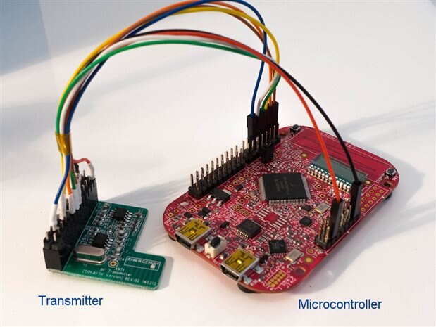

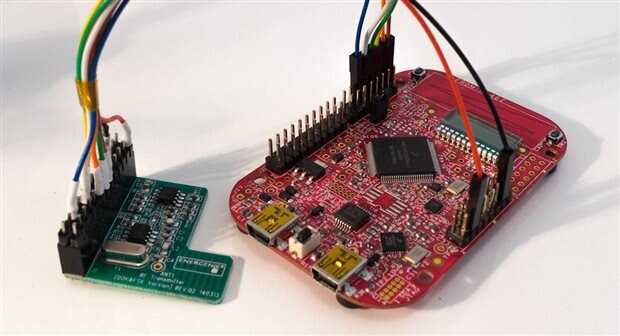

The next step was to create a small adapter cable (or just use jumper cables) to plug into the Energenie module, to allow it to be connected to non-RPI boards. I used a FRDM board as a quick test. Any board including an Arduino could be used (but make sure that the supply and signal levels are 3.3V, not the default 5V that the usual Arduino offers).
Finally the python code was translated. There is not much to it – it is so short it is self-explanatory.
Here is some example code which would work on FRDM boards; this code switches a socket on and off repeatedly. Refer to the Energenie documentation to see the d0..3 combinations for controlling additional sockets.

With this code you can hear the socket switching on/off (i.e. there is presumably a relay inside).
