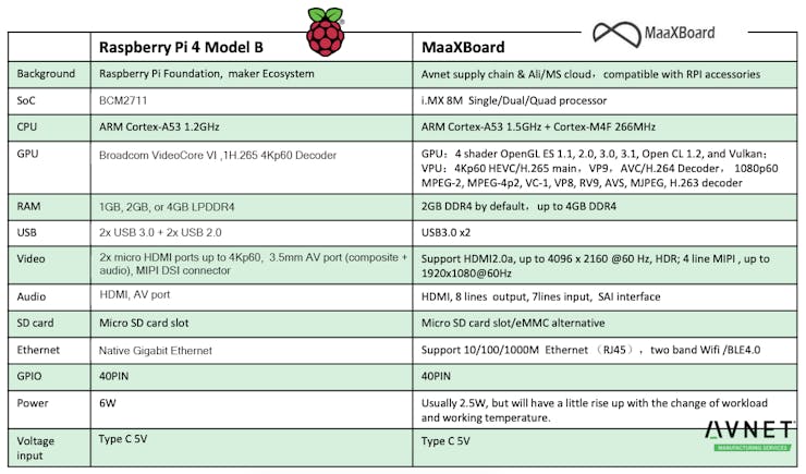

Avnet's MaaXBoard, which is based on NXP i.MX 8M, is kind of like Raspberry Pi, but with hi-def video and audio processing.
MaaXBoard is designed using the NXP i.MX 8M processor based on Armimage Corteximage-A53 and Cortex-M4 cores. It provides 20-channel hi-fidelity audio and 4K video processing for applications that scale from consumer home audio to industrial building automation and mobile computers. If you're curious how MaaXBoard compares with Raspberry Pi, here:

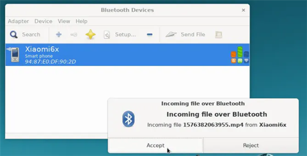

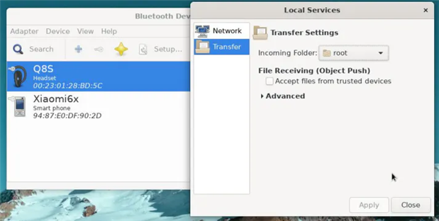

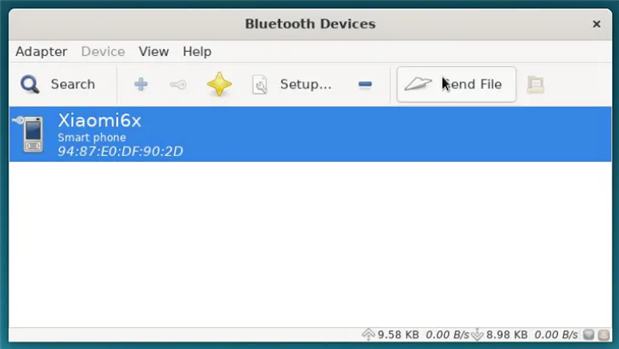

7.b Sending and Receiving files over Bluetooth
Send a file:
On Windows, open bluetooth and select "receive a file."
On your MaaXBoard, right click on your bluetooth device and select "send a file." Select the file that you wish to send.
Receive a file:
On Windows, select the MaaXBoard under bluetooth devices, and select "send file." Select the file you want to send.
On the MaaXBoard, select "accept" when you see the notification "incoming file over bluetooth."
By going to "View">"Local Services, " you can select the incoming folder for receiving files.

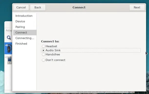

7.c Connect Bluetooth Audio
MaaXBoard supports connecting to a Bluetooth audio device, such as a Bluetooth headset, to play audio files.
  • Pair the device first:
Pair the device at first.
  • Right click and choose “Connect to: Audio Sink”
NOTE: I got the error "Connection Failed: blueman.bluez.errors.DBusFailedError: Protocol not available, " when I tried to connect to audio the first time, but after restarting the board I was able to connect to my paired device.

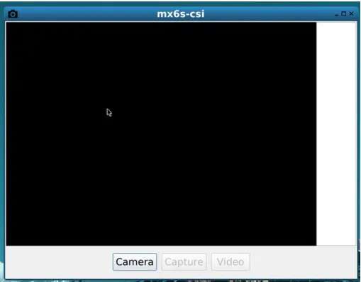

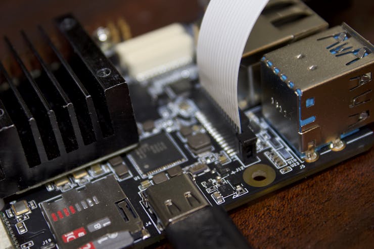

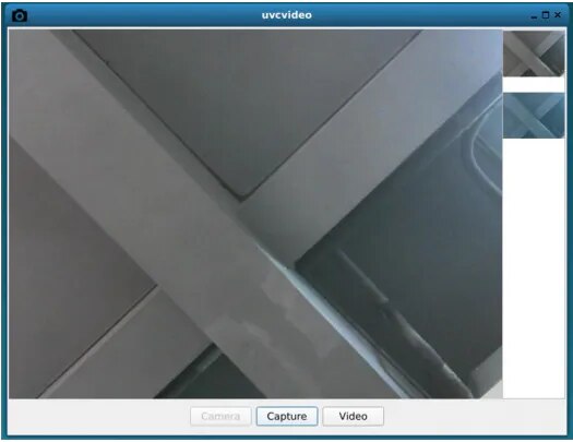

8. USE THE CAMERA
MaaXBoard supports both USB Camera and MIPI-CSI Camera. Attach a MIPI-CSI camera by lifting up the back part of the black MIPI camera connector on the board. Insert the camera's DSI ribbon cable. The blue side should face the Ethernet and USB ports. Gently press the MIPI camera connector down so that it grasps the ribbon cable firmly.
Plug the MIPI CSI camera into the board
Open the camera application and select "mx6s-csi." On the next screen press "Camera." Select "capture." If it doesn't, double check that the ribbon cable is all the way in.
If you insert a USB camera, click "reload" and you will see a "uvcvideo" button that you can use to take photos from the USB camera.
If your input device supports video, you can also take a brief video (20 seconds or less). Change the length of the video by selecting the "Record time." Videos are saved as.yuv files. Weston comes with a video player, Totem, but it's not able to play.yuv files. To replay them you'll need a video player like mplayer. Install it:

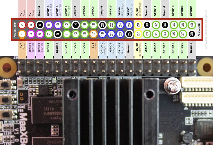

9. GPIO
As you may have noticed, MaaXBoard has the same header pinout as a Raspberry Pi, and is Pi hat compatible:
Maxboard pinout
Maxboard pinout

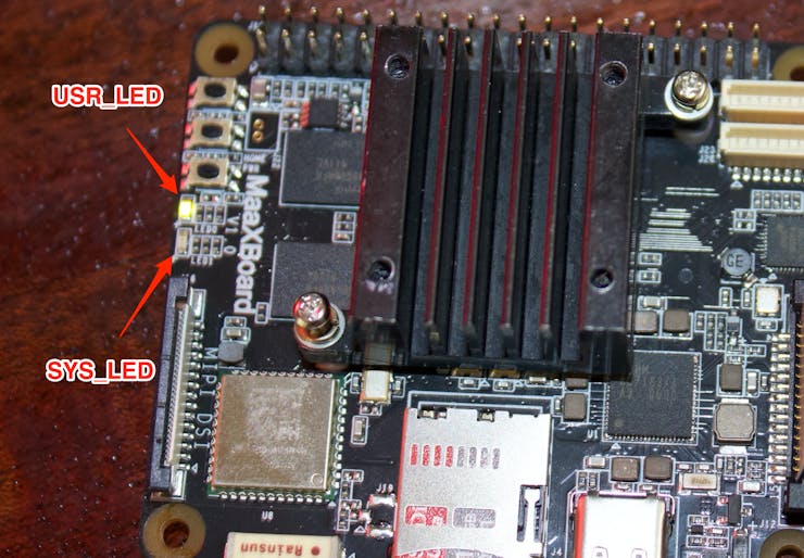

9.a LEDs
The board comes with 2 onboard LEDs, sys_led and usr_led.
You can toggle them via bash.
Toggle usr_led:
echo 1 | tee /sys/class/leds/usr_led/brightness
echo 0 | tee /sys/class/leds/usr_led/brightness
Toggle sys_led:
echo 1 | tee /sys/class/leds/sys_led/brightness
echo 0 | tee /sys/class/leds/sys_led/brightness

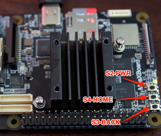

9.b Buttons
MaaXBoard supports 3 buttons: S3-BACK, S4-HOME and S2-PWR.

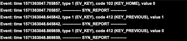

Remember we installed evtest earlier? Run it in bash now:
evtest
It prompts you to "choose the device event number [0-2]." (there may be more than two possible choices -you should see a list of input devices in the bash output)
If you select whichever number is gpio_keys, it will see all of the available button event codes, including those of your keyboard. Test S3-Back and S4-Home.
Press S2-PWR and the system will enter suspend mode; press PWR again for 1 second and the system will reboot.
