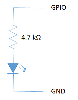

Now that the python GPIO libraries are installed and working correctly, let’s put them to work. First, create the circuit shown in the image below:

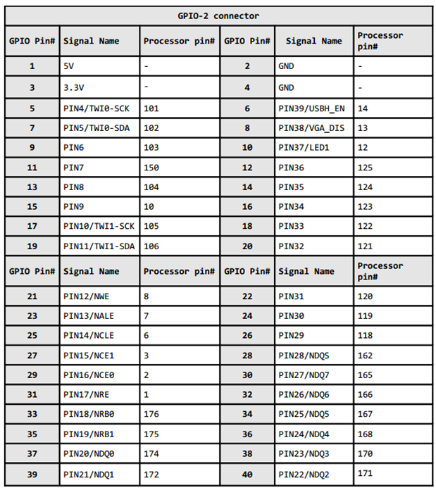

Now, you can pick any GPIO pin on the board that you want.  I picked GPIO PIN6, which is physical pin 9 on the GPIO-2 connector. A description of the GPIO pins can be found in the OLinuXino user manual, and is shown here:

Now we can write a python script that will blink the LED on/off.  Here’s the script to make that happen:
Once you copy that over into a file called blink.py then you can run it with:
python blink.py
And the LED that is connected to PIN6 should blink!
The code is pretty straight forward.  It starts by initializing the GPIO library.  Then it sets the GPIO PIN6 to be an output.  Next the code goes into an infinite loop.  The loop turns the LED off, then sleeps for a second, then turns the LED on, and finally sleeps for one second before repeating.

The only interesting thing about the C example is trying to figure out which GPIO pin is which.  To do this, you can look at the python GPIO library source code (pyA13-0.1.12/source/pyA13.c).  At the very top there is a list of #define statements that show how to access the various GPIO pins.  I just copied over the one that applied to GPIO PIN6.
