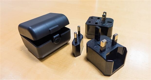

Fit the supplied watch battery for the real time clock (RTC) on the rear of the board, and then plug in a keyboard, mouse and monitor, a network cable if desired and insert the supplied microSD card, connect up the supplied power supply (12V) and then press the ‘Power’ button on the board. Once booted up, a slightly bizarre user interface is displayed at the top of the screen that is unintuitive enough that the supplied instructions are needed to figure out how to use it (to save time: basically you cannot click on an icon, but rather you have to drag the entire icon bar left or right so that the desired icon is centered on the screen).
