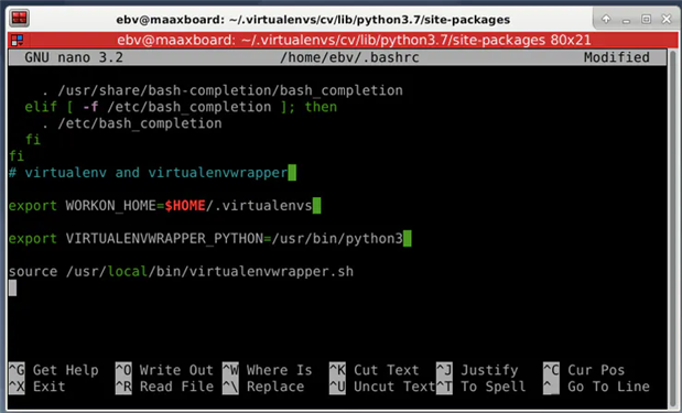

now as user “ebv” (this was created in the prerequisite headless setup) we edit our bash shell configuration file ~/.bashrc using nano:
nano ~/.bashrc
and at the very bottom of it we add these lines:
# virtualenv and virtualenvwrapper
export WORKON_HOME=$HOME/.virtualenvs
export VIRTUALENVWRAPPER_PYTHON=/usr/bin/python3
source /usr/local/bin/virtualenvwrapper.sh
Save with CTRL+O, exit with CTRL+X and make sure you reload your shell config with:
source ~/.bashrc
