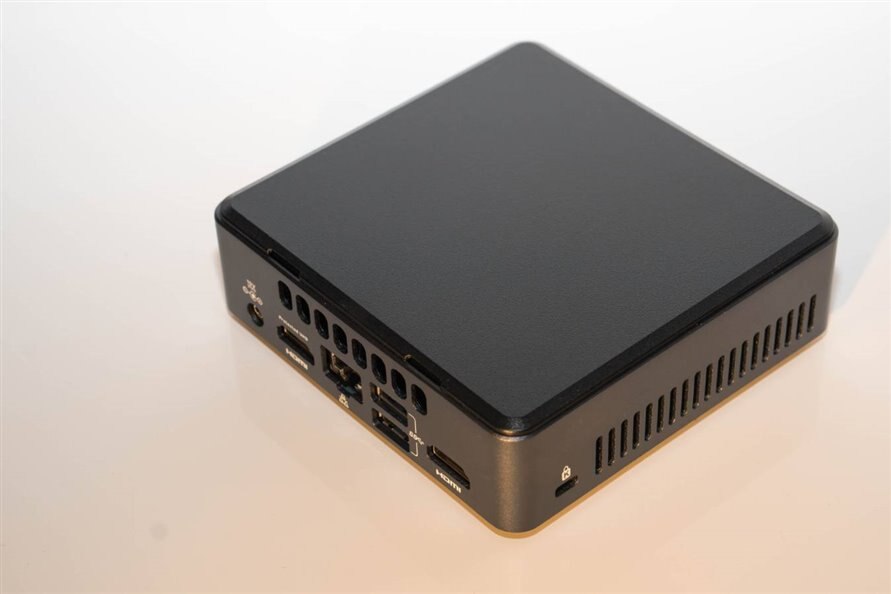

The Intel NUC is a really tiny PC at approximately 115x111x37mm. Whilst not completely silent (it has a laptop-like cooling system) it is extremely quiet and reasonably powerful. The version in the photo is the Intel i3-7100U variant (2.4GHz, 3MB cache, dual core with 4 threads total), but Intel i5 and i7 options are available too. The NUC also contains 802.11ac Wave 2 wireless (which far exceeds 100Mbit Ethernet speeds - it approaches Gigabit Ethernet speeds, but needs an appropriate wireless access point) and Bluetooth Classic and Bluetooth LE (BLE) version 4.2.

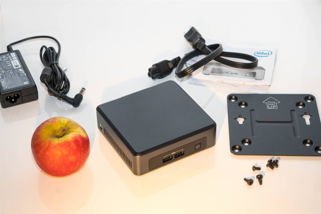

The NUC comes in a tiny box – inside there is the NUC itself, DC power brick from a reputable manufacturer, (the supplied cable has a C5 connector which is less popular than C13 : ( and a plate to mount the NUC on the back of a monitor if desired! The apple in the photo is there just for scale purposes.

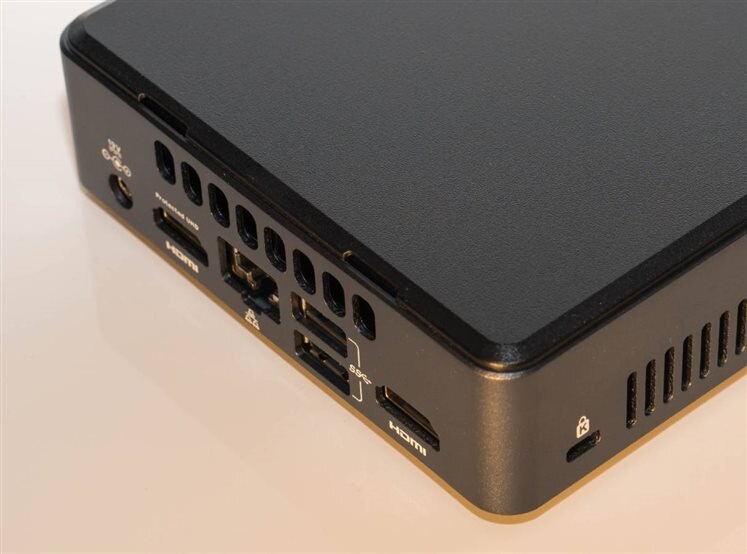

The NUC device is surprisingly heavy (almost half a kilogram!) for its size. The chassis internally is metal mainly (stamped/folded steel). The sides are metal too (it appears cast). The NUC has an illuminated power button and a couple of USB 3.0 ports on one side, and the other side has two more USB 3.0 ports, DC power socket (2.5mm inner pin2.5mm inner pin, 12-24V DC), Gigabit Ethernet, and two HDMI 2.0a connectors. The fan exhaust holes for air egress are located on that connector side too.
I like that so many USB ports are available! But there are a ton of connectors on the inside too that could theoretically be exposed with a bit of effort.

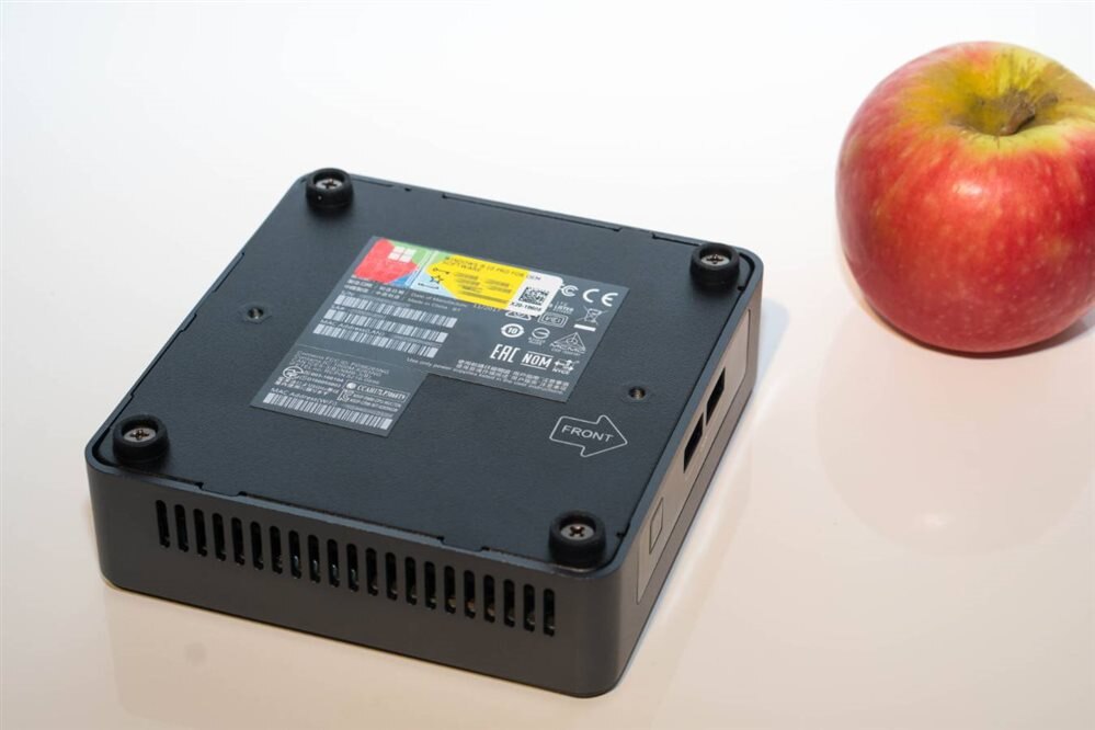

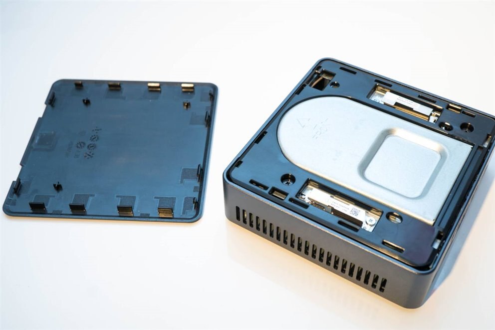

The underside is made of pressed steel plate, and has four caged screws which are the entry point into the internals of the NUC. Once they are undone, the plate comes off with no effort.

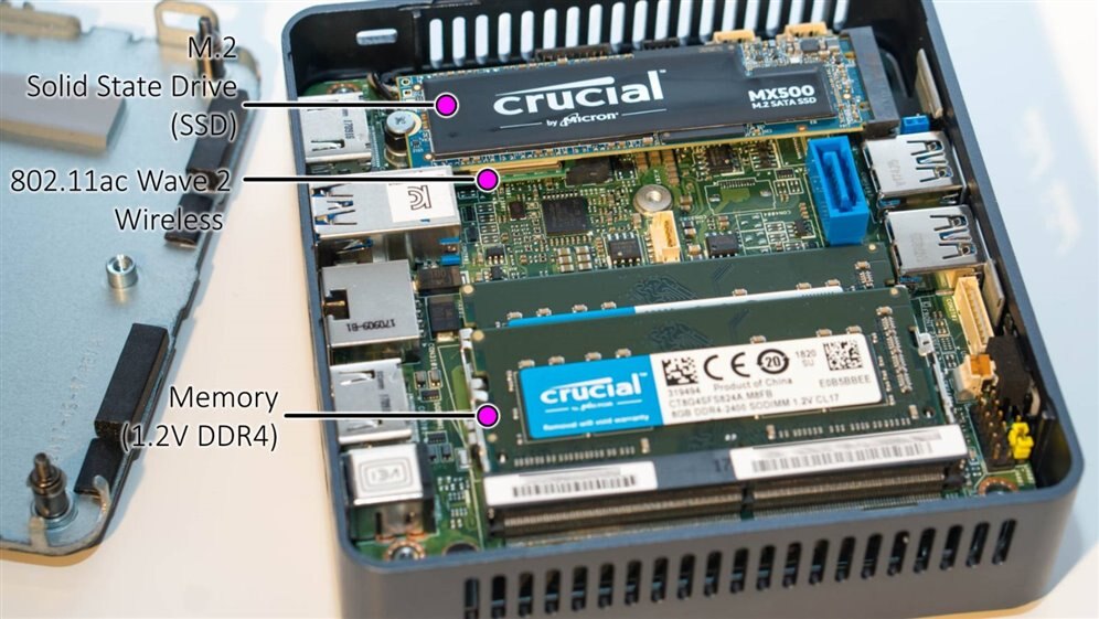

With the NUC opened, the tiny 4x4 inch motherboard is exposed. It is fairly packed inside the enclosure but there is a bit of space for very small user circuits if desired. The removed bottom plate has a thermal pad on it, which thermally interfaces the M.2 solid state disk (SSD) to the steel plate, to aid in a bit of passive cooling. There are electrically conductive pads on the edges of the steel plate for electromagnetic shielding reasons.
Barely visible under the M.2 SSD is the wireless card, in a smaller form-factor M.2 socket.

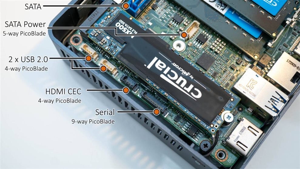

Up to 32GB of fast DDR4 memory can be inserted in total across two slots; my NUC had two 8GB sticks installed. The blue connector in the photos is a SATA port, at 6Gbps speed, for attaching optional drives. Power for the drive is available on a 4-way Molex PicoBlade connector (5V at up to 1.5A).
There are in fact lots of Molex PicoBlade connectors on the PCB! All ready for user expansion..

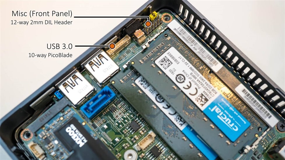

For those that need the very high throughput USB 3.0, there is a 10-way PicoBlade connector along another side of the circuit board too.
Of course, assembling a PicoBlade connector is extremely hard, since these are tiny 1.25mm pitch connectors. Fortunately it is possible to buy the connectors with wire ends pre-attached, or the wires already crimpedwires already crimped, all ready for pushing into a PicoBlade housing ( 4way4way, 5way5way, 9way9way, 10way10way housings ).
There is a 12-way 2mm pitch dual-in-line (DIL) header too, for some general purposes. A reset switch can be wired to it, and power and drive activity LEDs and 5V at 1A is available on it too.

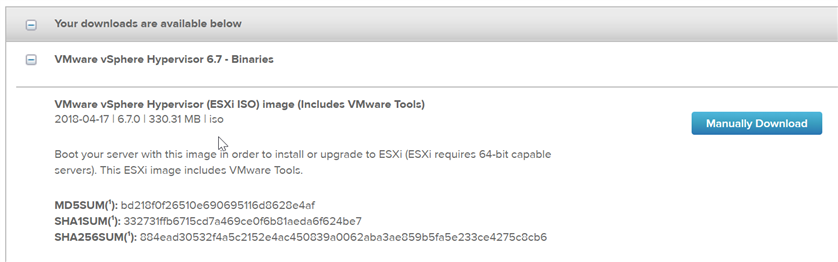

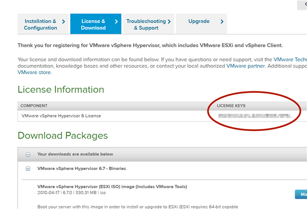

I wanted to have VMware ESXi installed on the NUC, so that I could run up to a couple of virtual machines, and swap around different VMs on demand. This proved to be very straightforward. I downloaded VMware vSphere Hypervisor (version 6.7 in my case), it comes as an ISO image of about 330MB as shown in the screenshot here.
While you're at it, make a note of the license key; it is visible just above the downloads:

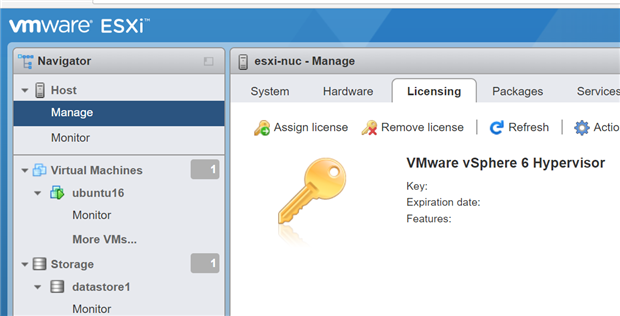

ESXi can be managed from a web browser. The first thing to do is to navigate to it from your browser, and then under Host click on Manage and then select the Licensing tab as shown below, and enter the license key captured earlier. Without that, ESXi runs in a 60-day evaluation mode.
