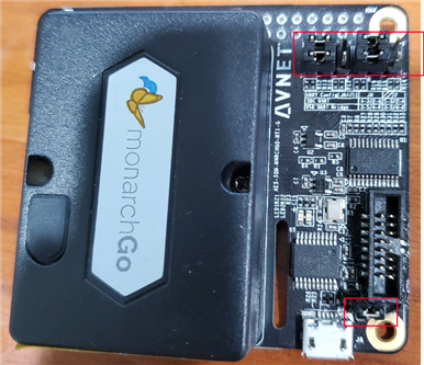

     The Monarch Go Pi hat can be operated in standalone operation via the MicroUSB interface
          Hardware Setup

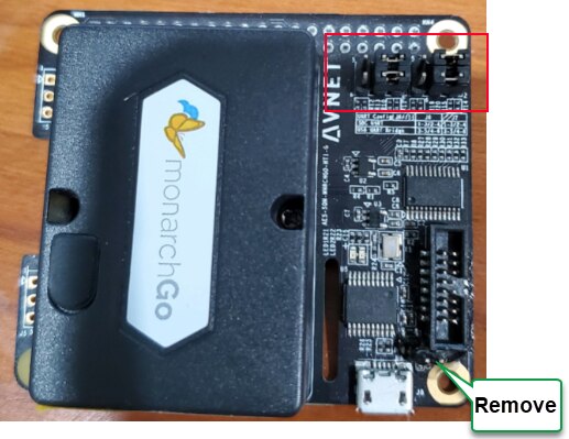

               1. Set the Moanrch Go Pi Hat Jumpers to Standalone operation
      • J6 : 3-5 / 4-6
      • J7 : 3-5 / 4-6
      • J10 : 1-2

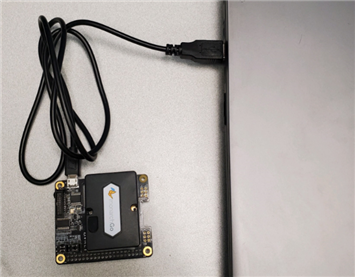

               2. Connect the Monarch Go Pi using the microUSB J8 connector on the Monarch Go Pi Hat to your PC using a microUSB cable
          Software Configuration

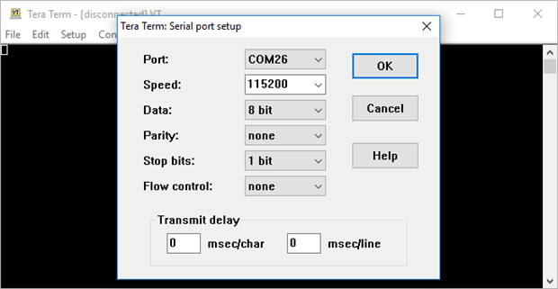

               1. Now that the hardware is all setup, open a terminal such as Tera Term or Putty and connect to the Monarch Go UART interface.
                   Please note your COM port will vary from the image below. If you cannot connect to the UART interface please verify the jumpers are configured correctly.

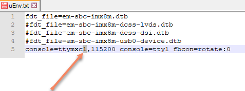

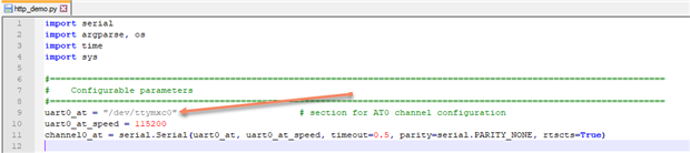

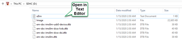

               1. For the MaaXBoard Debian image, the default UART used by console for communicating with the SBC is UART1 which is the same UART interface the Monarch Go Pi Hat needs to use.
                   We will need to change our console UART from UART1 to UART2. Open microSD Card in the windows explorer.
                   Open the un.ev file using a text editor, change console=ttymxc0 to console=ttymxc1
                   See completed change in image below for reference. Make sure to save and exit the text editor

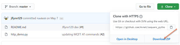

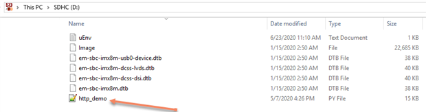

               2. Now that the console UART interface is configured correctly, lets grab the application we will be using from the Avnet GitHub.
                   Go to github.com/Avnet/sequans_python Click Clone -> Download ZIP
               3. Unzip the ZIP file and paste the http_demo.py onto the microSD Card
               4. Before we eject the microSD Card open the http_demo.py application using a text editor.
                   In the case you are using a different Single Board Computer from the MaaXBoard, you may have to define the correct UART interface based on your hardware.
                   In this case it is already configured correctly to work with the MaaXBoard.
               5. Safely Eject the microSD Card.

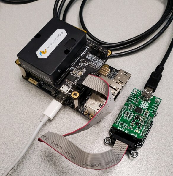

          Hardware Setup
               1. Set the Monarch Go Pi Hat Jumpers to Single Board Computer Operation
      • J6 : 1-3 / 2-4
      • J7 : 1-3 / 2-4
      • J10 : No Connect
               2. Connect the Monarch Go Pi Hat to your SBC 40 pin GPIO Raspberry Pi Hat
               3. Optional : Connect up the shuttle click interface to the MaaXBoard. Install the Microchip USB I2C click onto the shuttle click.
               4. Insert the microSD Card into the MaaXBoard and connect the power supply. The MaaXBoard should power on.
          Running the Application
               1. Now that the board is powered on, connect to the terminal UART2 interface of the MaaXBoard using Tera Term or Putty.
                   This can be done by using the optional shuttle click and Microchip USB I2C click.
                   Another option is using the HDMI interface or SSH into the board.

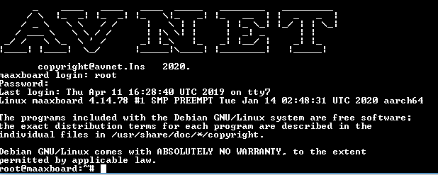

               2. Login to the MaaXBoard using the Username/Password root/avnet
               3. Go to the boot directory in the image to find the http_demo.py application. Enter the following commands cd /boot and then enter ls to see the files in your location.

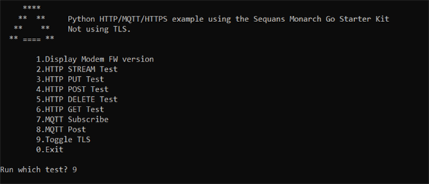

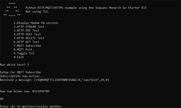

               7. Now lets run the Python3 application enter python3 ./http_demo.py You should see a menu similiar to what is shown below.
               1. I'd reccomend starting with Entering 1 This will show your frimware version and verify communication between the modem and the SBC

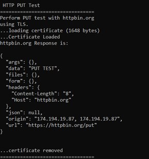

               2. For the HTTP communications examples, the script interacts with http://httpbin.org--a simple HTTP Request & Response service--by sending PUT, POST, GET, DELETE, and STREAM commands.
                   When httpbin.org receives the commands, it echos the command back.  An example using a PUT command is:
               You can also use HTTPS rather than HTTP by toggling TLS prior to issuing the command.  In the example above, TLS was enabled so the response url is displayed as "https://httpbin.org/put".

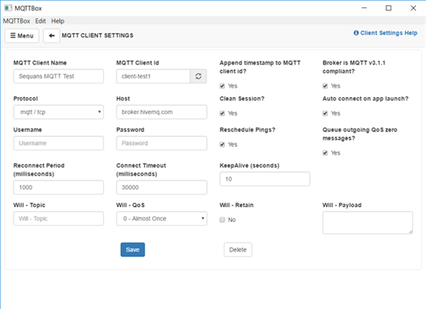

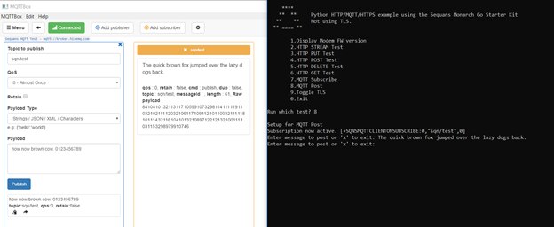

                3. Using the MQTT Interface

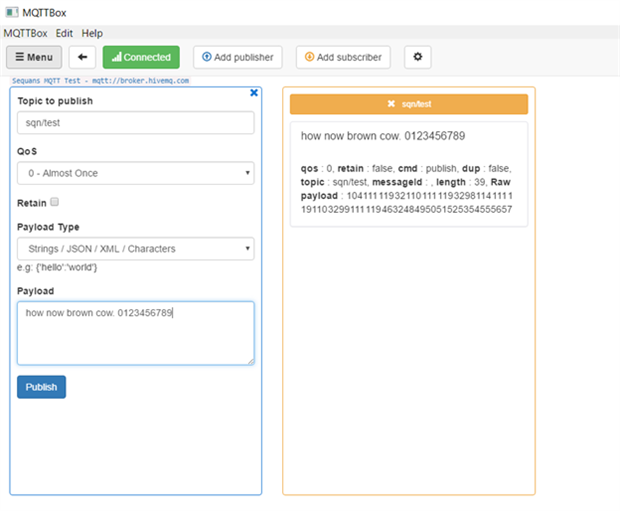

                    a.The example script also supports posting and subscribing to an MQTT exchange. To demonstrate interaction with an MQTT broker, the script uses HiveMQ and the Chrome browser application MQTTBox.
                        To begin, setup the MQTTBox application to use an MQTT Client id of 'client-test1' and a Host address of 'broker.hivemq.com'. This will allow you to monitor and post to topics from within MQTTBox.  The setup should look similar to:
                    b.Once configured, you can monitor and post topics.  In the script, 'sqn/test' is the topic used so when posting to the Sequans module, use this topic (in the Topic to publish box) and whatever Payload you would like will be sent to this topic.
                       When the 'Publish' button is pressed, the payload will be displayed on the right side of the dialog showing the payload for the 'sqn/test' topic.  An example of this is shown below:
                    c.Using the example script provided, select either 7 or 8 to Subscribe/Post messages between HiveMQ, the MQTTBox application, and the Python script.
                       For example, in the following screen shot, an MQTT Subscribe action has been executed and the script then waits for a subscribed message to be received.
                       When the payload is posted to the 'sqn/test' topic using MQTTBox, it will also be displayed in the Python Script as shown below.
                  Similarly, when a Post is executed by the Python script (selection 8), the published message is displayed within MQTTBox as shown below:
