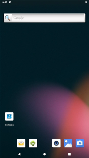

When your board boots, you'll see the Android enviroment.
NOTE: Be careful when handling the board when it's powered on, because the heatsink can get very hot.

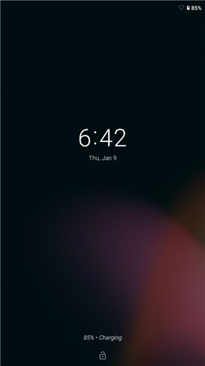

This initial boot will take a few minutes. Slide up to unlock the screen and enter the HOME page.
Congratualtions! The Android image is offically booted, now lets take a look at the features available!

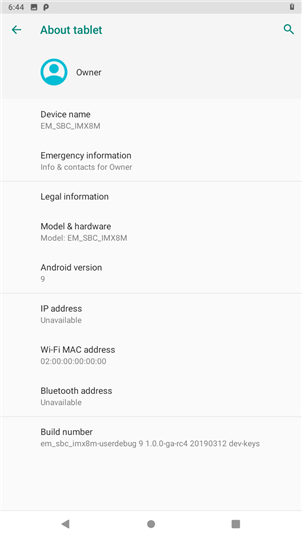

Lets start off by verifyng the software versions used. Slide up to show the APP list. THen Go "Setting" -> "System" -> "About table" Here we can verify the software versions.

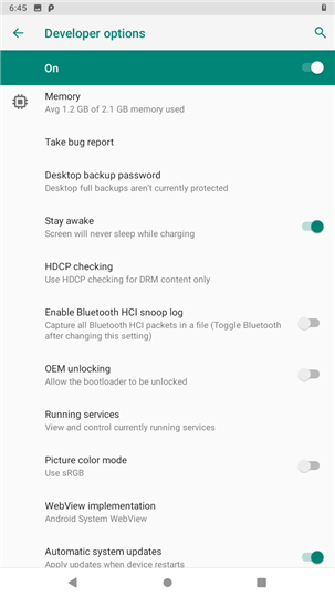

One thing you will want to do from the settings menu is enable Developer options. Do so by going to "Settings" -> "System" -> "About tablet" then tap "Build number" multiple times. When you tap the option, it will prompt : you are now x steps away from being a developer. Continue taping until the system prompts "You are now a developer!" Then go back to the "System" page and you will find "Developer options" you can enable or disable them from this setting. Take a look at the available options such as USB debugging, stay awake, etc. All are beneficial for developing users. If you would like to learn more about using these developers options take a look at the Android Getting Started Guide which can be found at Avnet.me/maaxboard under the Technical Documents section.

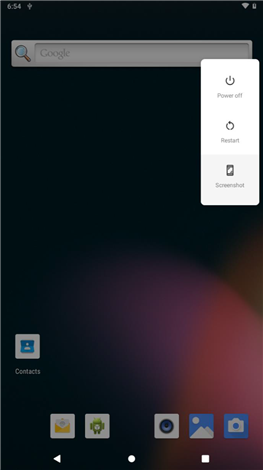

Short Pressing the PWR button on the MaaXBoard will put the system into a sleep mode. Pressing it once again will allow the system to resume from sleep. Long pressing pressing the power button will prmpt a 3 option menu on your display aloowing you to either Power off, Restart, or take a Screenshot.

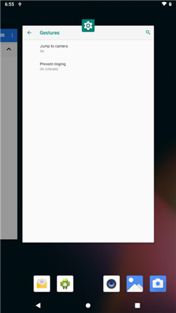

If you navigate to "Settings" -> "System" -> "Gestures" and ebale the "Jump to camera" option, you can now press the PWR button twice to quickly open the camera application.

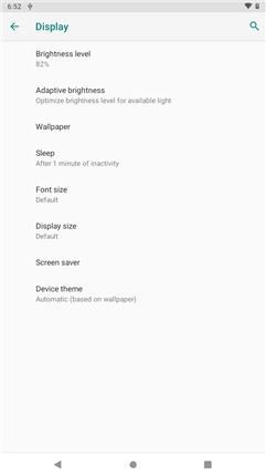

     5.4 Display Settings
Lets now check out the various display configurations we have acccess too. Go to "Settings" -> "Display". At this screen you can adjust the Brightness, Sleep, Font Size, Display Size, Screen saver and more.

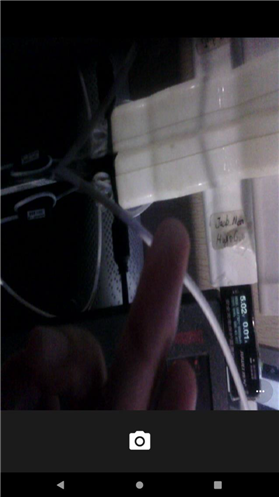

     5.7 Camera Interface
The MaaXboard can support both a USB camera (USB1) and MIPI-CSI Camera. The reccomended MIPI-CSI camera can be found here https://www.avnet.com/shop/us/products/avnet-engineering-services/aes-acc-maax-cam1-3074457345642357172/

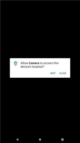

Connect up the desired camera and open the camera APP, choose "Allow" in the pop-up window. It will then show the cameras prview. Click the catch key to capture the photo.

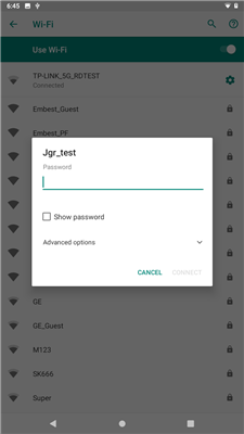

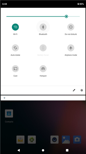

     5.8 WI-FI
You can enable and disable the Wi-FI using the system drop-down box.
Go to "Settings" -> "Network & Internet", here you can also enable or disable the WI-FI interface.
Click to enable it then "Use Wi-Fi", ti will auto scan for available networks. Click the network you wish to connect to and input the password. You have successfully connected up the WI-FI
