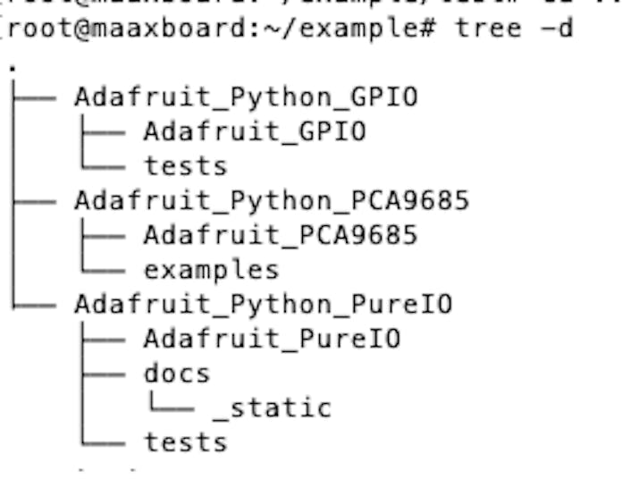

Install tree so you can check the directories:
sudo apt-get install tree
Now print the directory tree:
tree -d
The example directory's tree should look like this:
