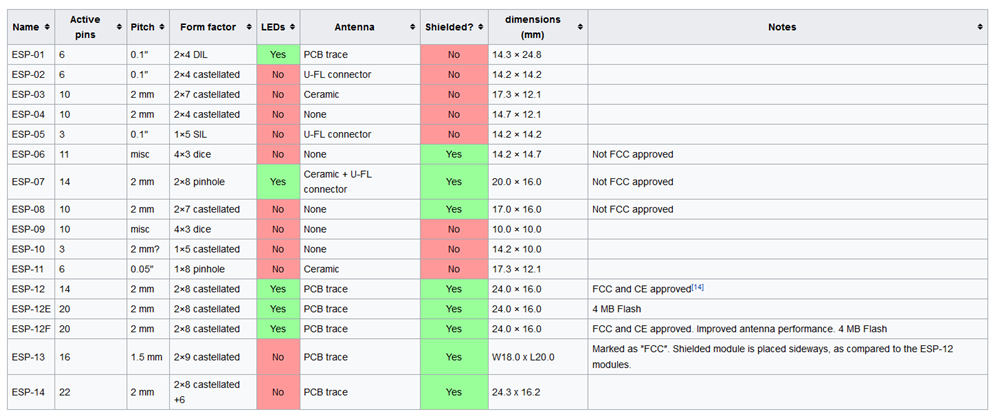

Something that you will need to be aware of is that there are several iterations of the ESP8266 all with slightly varying specifications and pin assignments.
Wikipedia’s chart of ESP versions.
