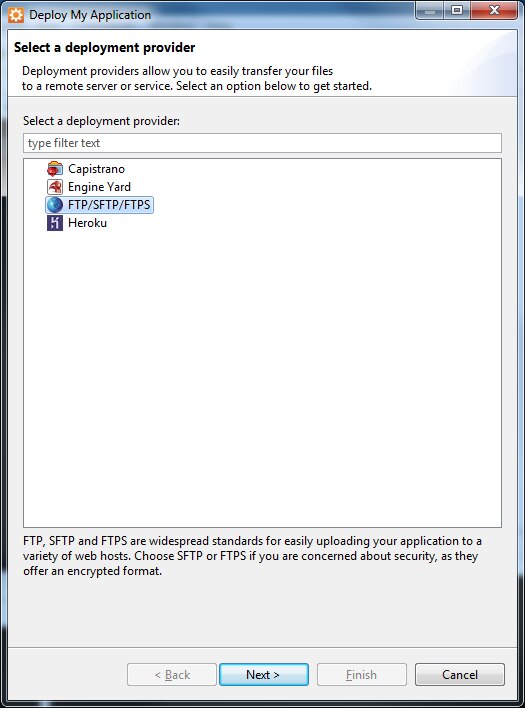

Since we created an SFTP connection earlier, we want to use that type of a deployment provider.
This will bring up a form that looks very similar to the one before, but with some more options at the bottom.  Check the box to automatically synchronize the changes and click finish.
