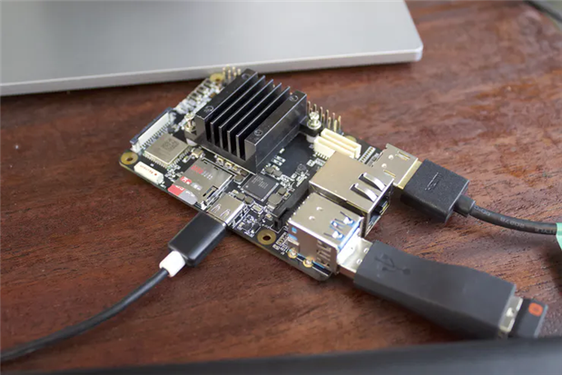

The following hardware is required for following along with this blog.
a) MaaXBoard SBC - www.avnet.me/maaxboard-buy
b) USB Serial converter or some other way of getting terminal access such as SSH or HDMI terminal connection
c) 16GB SD Card Link
d) USB Type C Power Supply Link
Now that you have the required hardware lets look at where to find the image required to run this demo.
Download the Debian Out of Box image by going to www.avnet.me/maaxboard  Reference Designs -> Out of Box Image -> Debian Linux Out of Box Image.
You can then use a program such as Win32DiskImager or Etcher.io to flash the image onto the 16GB SD Card.
Insert the SD Card into the board. Plug in the device you wish to get terminal access ffrom whether that is via a HDMI monitor w/ mouse and keyboard or via SSH or a USB UART TTL converter. Plug in the USB Type C power supply to power on the board.

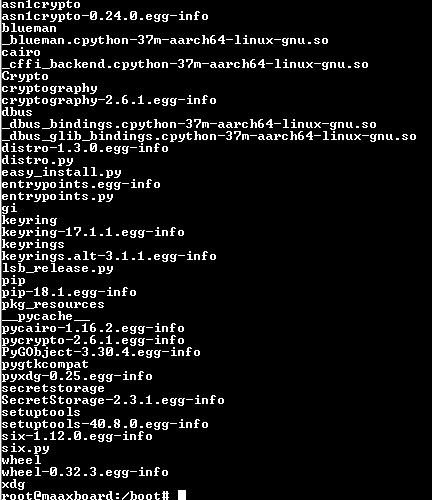

b) Use the ls command to explore the available python libaries
     Once doing so youcan see the supported Python installs. In the MaaXBoard out of box case it supports Python 2.7 / Python 3 / Python 3.7
     Later on in this blog we are going to be exploring using Python3, so lets dig a little bit deeper in regards to the distribution packages with this Python3 install.
     Using ls once again image
     We get a list of available distribution packages with this install
     In the event of needing an additonal package in your application, once you install it using apt-get install you can run the same LS command as above and see the newly added package here.
     For example we are going to be using the python serial application. Connect your board up to the internert via Lan or Wifi and run the following command.
After the new package is installed run the same ls command above to see the newly added package "serial"

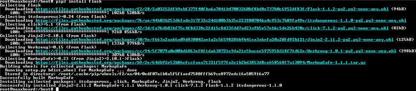

Installing Flask using pip3
a) using pip3 install flask using pip 3 (pip3 install flask)

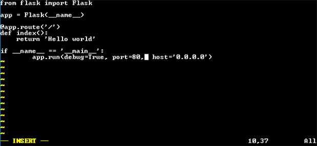

b) Similiarly as what was done with the hello word example use vi to create / edit an application labeled app.py. Refer to below with what to put in this application. Now save and exit the vi editor. PLEASE make sure everthing is copied exactly as shown
from flask import Flask
app = Flask(__name__)
@app.route('/')
def index():
  return 'Hello world'
if __name__ == '__main__':
  app.run(debug=True, port=80, host='0.0.0.0')

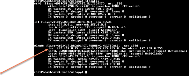

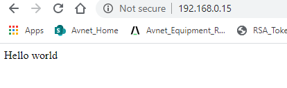

c) Now that you have created the application, use ifconfig to determine  wlan0 IP address so we can access the webserver over the local network. In my instance it was 192.168.0.15. Please note if you dont have an IP address you will need to connect your MaaxBoard to the internet via Lan or Wifi.

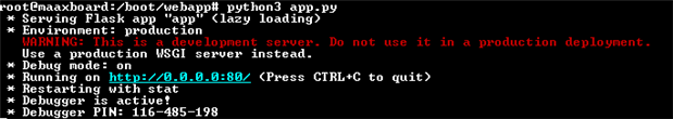

d) Now we get to run the application and then view the webserver from our PC.
     i Run  the applciation similiarly to the Hello Python example earlier
     ii. Assuming your PC is on the same network as the MaaXBoard, open up a webrowser and type in the IP address we found in step C to open the webserver we just created.
If everything was done correctly you will see Hello World in the webrowser!
