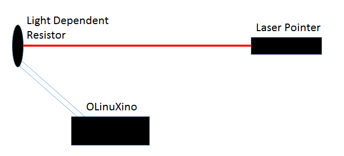

So, in this blog post I’m going to use the OLinuXinoOLinuXino to build a device that will automatically count the number of repetitions that I've done.  This way I’ll never lose track again!  To do this, I’m going to build a trip wire and position it so that when I go through the range of motion for the exercise that I’ll set off the trip wire.  I’ll then count how many times the trip wire has been activated and use that to keep track.
The system looks something like this:

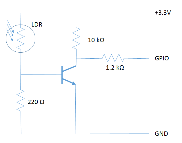

First, build the circuit shown below:
This circuit is set up so that when the laser pointer is shining on the light dependent resistor (LDR) that the GPIO pin will read zero.  When the light goes away, the GPIO pin will read one.  The way that I think about it is that the GPIO pin answers the question: Is there an object between the laser and the sensor?  If the answer is yes, then the output is one.  If the answer is no, then the output is zero.

Now comes the hardest part, lining up the laser pointer so that it will shine on the light dependent resistor.  This can be tricky since the beam of the laser pointer is so small.  Also, this needs to be done in such a way that the natural range of motion for the exercise will break the beam when it is performed, but only when the exercise is performed.  (Not when you are resting.)  Sometimes this can be tricky to find a point that will always be passed through.  For jumping jacks, I found that positioning it so that it detected when my arms came up worked well.  This had the side effect that it would detect when I raised and lowered my arms.  This means that I would get double credit for every rep!  That’s not what we want, so with a small software modification, we can count every other detection.
