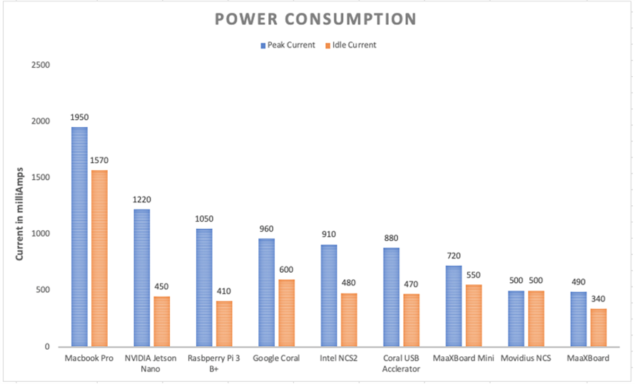

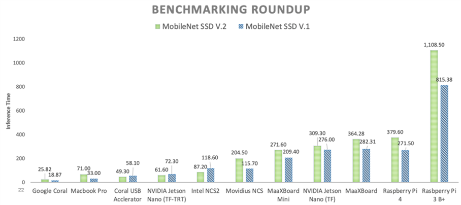

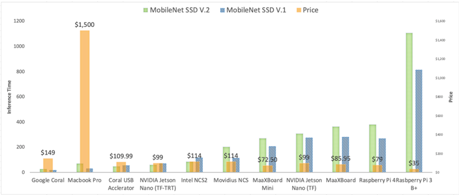

Last spring I benchmarked machine learning inference on the MaaXBoard against similar single board computers. I looked at speed and power consumption while running inference using the object detection models MobileNet SSD V1 and V2.
Recently, I benchmarked the slightly faster MaaXBoard Mini against the same boards. Here are the results in graphs.
Results for speed:
Results for Power Consumption:
Results for Price:
