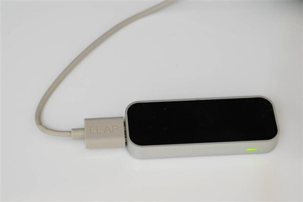

The Leap Motion Controller is something that can be used as an input device for a computer (desktop/laptop or a single board computer). It can be placed on the desk, or if desired can be strapped onto a virtual reality (VR) headset if you have one. In brief, when it sees your hand or hands, it can analyse them to figure out where your fingers, palms and so on, are in three dimensional space. It can also figure out certain movements such as swipes. You could use it for controlling stuff, or even controlling Python games.
It is only just bigger than a USB memory stick, so it is quite compact.
Here is a snippet of the possibilities, from the Leap website:
I recently noticed Leap Motion controller devices cheap on ebay, so I was curious to try it out. Knowing nothing about them, I was kind-of hoping to somehow get it functioning with ARM boards such as a Pi or BeagleBone Black, but sadly it appears that internally they contain little processing; all the sensor data is streamed via USB to a PC, which does the heavy processing, although apparently Android support is coming soon. Internally, according to online teardowns, there are a couple of CMOS cameras with fish-eye lenses, and a few infra-red (IR) LEDs, and a Cypress chip to stream all the captured data to the PC. The top surface is a plastic IR filter. With the fish-eye lenses, the Leap Motion Controller gets to see a space about the shape of a hemisphere of 600mm radius which is pretty huge. There is more information about how it works on the Leap website.

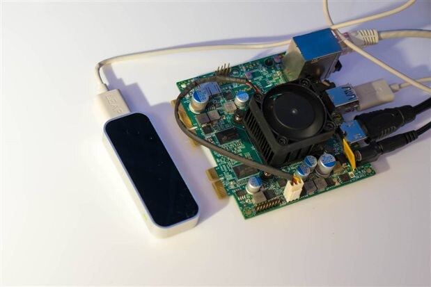

Apart from the Leap device (which comes with USB cables), just a x86 or x86-64 PC or single board computer.  This works on any reasonable PC. The Leap website suggests an Intel Core i3 or upward processor, or AMD Phenom II upward, and 2GB of RAM, I tested it on a laptop which met this requirement, but I also tested on a Gizmo2 (which sadly isn’t sold any more) – and that has just a low-power AMD chip and 1GB of DRAM! It seems to work fine in my limited tests.
The Gizmo2 and similar compact boards allow for the Leap Motion device to be used for embedded or kiosk applications. Sadly the Intel IoT boards like Joule are end-of-sale too, otherwise it would have been really neat to try that. I think it would have run really well on that!

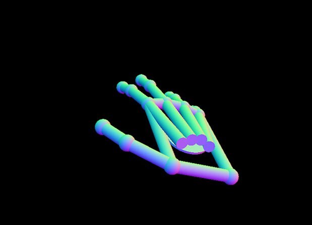

Now open up a browser and navigate to http://127.0.0.1:8080/index.html
You should see a black screen.
Hover your hand over the Leap Motion device to see it appear in the browser!

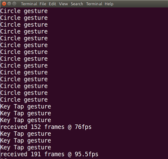

Then, just type:
./gesture.js
It will stream on the terminal text output, whenever the hand is swiped etc. It is really basic, but demonstrates how to capture gestures in order to do something with them. Currently it just logs to the console.

    I'm fairly sure this won't work, it will definitely need an x86 machine. Fortunately it doesn't take a lot of resources (despite what the Leap SDK requirements say), so a cheap compact PC will work - e.g. an old laptop, or something like a Gigabyte mini-PC, or (more expensive) an Intel NUC. If you can find a used or old version NUC, it would be good enough for the Leap.
    For my first experiments with Leap, I used a virtual machine running Linux, on my Windows laptop. Then I used an old AMD Gizmo-II board (very obsolete, so not worth getting that nowadays).
