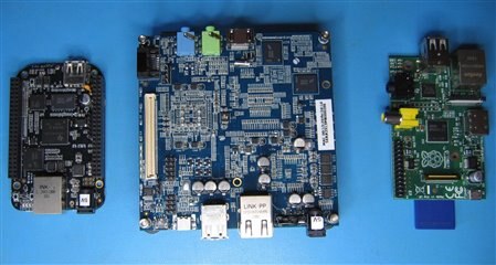

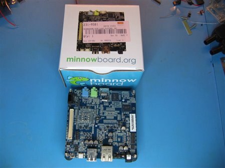

Just received the minnowboard today, so here's a couple of first impressions.
Two and a bit times the size of a BeagleBone Black, but still tiny for a x86
LED's are green, not blue image

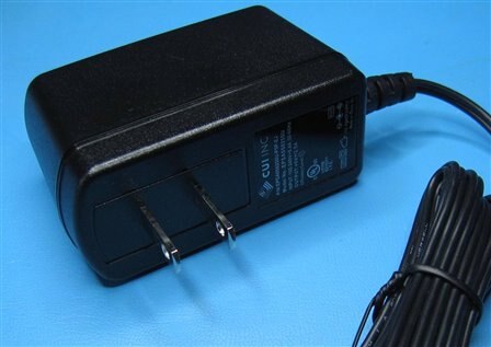

Supplied with psu that has a US 2-pin plug on it.  While I understand these are made in the US, that's not really a good enough excuse when they're being sold elsewhere.  The SL did the same even though it's built in China.  e14 if you're listening, stop doing this, these useless psu's are going straight to landfill.

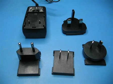

A good example to follow would be the freescale i.MX5-QSB which came with a PSU that had a swappable plug and enough adapters to cover most of the world. Otherwise, rather than a wall-wart, just put in a PSU that has a standard IEC inlet. Letting the user source a local power lead would make lots more sense.

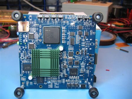

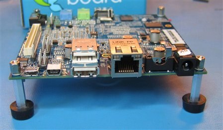

Some photos:
Yes, it comes with the standoffs and feet..

    Ironic to name such a warm board after a cold-blooded animal image
    Also rather bizarre to have the hot components on the bottom side of the board, though I guess you could run it upside-down if the LEDs are on the edges.  Or better yet, vertical mount like my RasPi.
    I saw a minnowboard at Design West last April and I was shocked by the number of SMT resistors and capacitors.  Even so, it could be a candidate if one needs PCI express.  I may need PCIe some year if my PCI FPGA needs to upgrade.  Sabre Light and perhaps Wandboard are other potential candidates.
    e14 Contributor over 13 years ago in reply to johnbeetem
    To be fair, the majority of the caps are decoupling under the pch & cpu. I'm not going to fault them for a decent power design image   There does seem t o be a lot of resistors, a good portion of which are currently zero ohm.
    There's potential for two PCIe x1 lanes on this, i.MX6 has only has one - or at least only one exposed on the SL.  I'm slightly more keen to try PCIe on the minnow as the differential clock is available on the expansion header.
    I'd mostly given up on the idea with the SL, the clock isn't exposed so there's a possibility I'd need to provide one and I wasn't having much luck finding a simple device to do it.
    Doesn't look like there's any real reason not to put the board the other way up other than making it more difficult to access whatever expansion board you may have installed.
    shabaz over 13 years ago in reply to johnbeetem

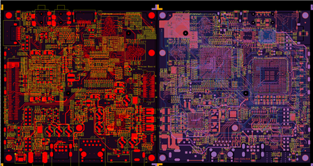

    It's definitely well decoupled :-)
    They look like nice board-to-board connectors, I was looking for something with some density, but not impossible to solder - I just had a look on Farnell, the 0.8mm pitch on these looks good.
    According to the BoM on the site, there are over 400 capacitors there :-)
    And the gerbers were there too, so I couldn't resist looking - it's a 8-layer board.

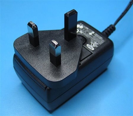

    Pictures are better than words, I'm in the UK, so need one of these:
    You likely need something different, depending on where in the world you are.
    The SL and Minnow come with these
    The i.MX5-QSB came with this
    just pick the adapter plate for your location.  This still lets the manufacturer blindly drop in a single PSU type, but far fewer will get binned 10 seconds after opening the box.
    there's a lot of power and ground planes in there...
    8 layer is certainly not going to help keep the cost down
    And to optimize costs and reduce landfill still further, in each jurisdiction they could add in just the single appropriate adapter plate.
