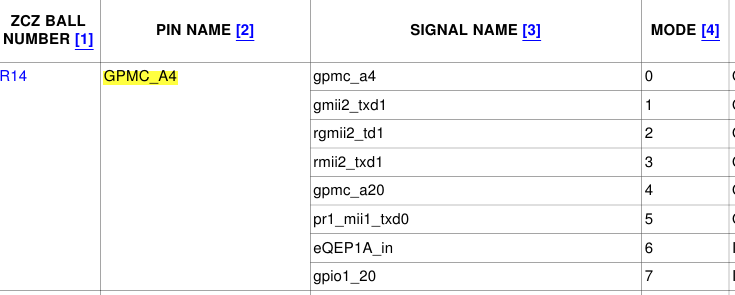

    Isn't gpmc_a4 the same as gpio2_10 in mode 1? I'm looking at page 83 of the BBB-SRM.pdf manual.
    e14 Contributor over 12 years ago in reply to e14 Contributor
    No, you're mistaking the logical function with the physical pin. The physical pin name for P8.41 is LCD_DATA4
    The tables in the SRM are mostly useless as they omit the important information.
    You're looking at this line from the BBB_SRM

    The important part is the T1 in the second column which refers the the physical ball on the BGA package
    Look in the AM3359 datasheet and you'll see this on page 31
    Fullscreen contentimage_180248.html Download
    <html><head><title>Jive SBS</title></head>
    <body><font face="arial,helvetica,sans-serif">
    <b>Error</b><br><font size="-1">
    An general error occurred while processing your request.
    </font></font></body></html>
    Then in AM335x Technical reference manual on page 759 you'll find
    The 8B0h refers to the offset from the base address of the control module which you'll find on p158
    Which gives you a pinmux address of 44e108b0,
    You pasted the boot log where it says
    [   11.352494] pinctrl-single 44e10800.pinmux: pin 44e10850 already requested by rstctl.4; cannot claim for panel.14
    so, different address means different physical pins.
    Your 44e10850 is
    on p758 of the TRM.  Go back to the datasheet and look for the 'Pin Name' GPMC_A4
    Note the ball number of R14 this time
    In the BBB_SCH.pdf, you'll find it on page 3

    It's the one connected to that inverter which then goes to eMMC_RSTn,  follow it through the schematic and you'll find that's the only thing it's connected to.
    So, going back to the message from your log
    So we have a pin that's used to reset the emmc being claimed by the rstctl (or reset control) driver.  That seems to make a lot of sense.
    As the pin doesn't connect to the expansion headers at all, it makes no sense whatsoever that it would conflict with a cape overlay that can't physically connect to the pin.  So that leads to the thought that there's either something wrong with the overlay you're using, or there's something wrong with how capemgr is attempting to merge the overlay into the base devicetree.
    Ok, hope that explains how I got from A to B...  If you're head's spinning trying to follow it, I absolutely understand.. The information being split across three documents makes finding exactly what's going on difficult at best.
