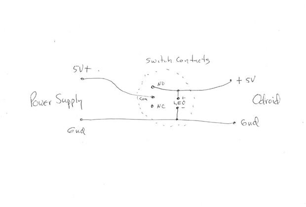

i was starting a new project and was wondering how to connect Adafruit Rugged Metal Pushbutton 16mm 6V Blue On/Off Latching NO and NC Switch a   to a ux4 odroid  single board computer i was wondering how to conect it and if i need to change anything in the script or need more power

    Hi Roger,
    The switch itself is just a switch and will work to open or close a circuit. The two leads that are the switch can be used in place of the switch you may be presently using. The LED light indicator has its own two leads. The specifications say that it is rated for 6 volts and since it is an LED its current draw is likely to be less than 20 mA. Since I do not know how you are using the switch, Power or digital input, I can't tell you the best way to power the LED. I suspect that it will work fine on the 5 volt supply of you odroid and you probably do not need to come up with the 6 volts in the specs. If your switch is being used to tell the computer something then you can probable add a line or two in the programming to turn on an output port to drive the LED. If you have an ammeter you may want to check the actual draw of the LED at 5 volts before hooking it to a port and then verify that its draw doesn't exceed the capabilities of the port. If you are using the switch to power the odroid then it is simpler and you can use the switch itself to turn the LED on and off. Note the LED has polarity and if not hooked up in the correct direction it will not light.

    and the switch i only know how to connect the positive and negative the problem was connecting the other three for the led which i have no idea where to connect them i just want it to turn the ux4 on and off with the light showing

    Hi Roger,
    The three contacts are the switch. It is a single pole double throw. The center is the common and then you will have to choose one of the others depending on whether you want the switch to be on with the button in or out. Here is a diagram of how to hook up the two light terminals.
