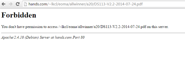

    shabaz over 10 years ago in reply to e14 Contributor
    Hi Luke,
    Excellent, thanks. However I currently get a 'permission denied' message, I think the file or folder may need changed permissions:
    e14 Contributor over 10 years ago in reply to shabaz
    doh! sorry  - sorted image  used rsync to copy it up, it often sets permissions to rw-------.

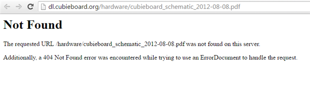

    found a comparable cubieboard set of schematics http://dl.cubieboard.org/hardware/cubieboard_schematic_2012-08-08.pdf

    I'm afraid I've given up. I tried accessing the new URL, and I see this:
    Besides, the URL states they are August 2012 schematics.. Is the project really using 4-year old technology?
    aww tooom, grrr, he's got a bad link on the cubieboard site (which is nothing to do with me btw).  i assumed he'd be keeping his site up-to-date *sigh* give me one second to find (and check this time!) cubieboard schematics... ok google "cubieboard schematics" and there's one that i've just double-checked downloads (it's a copy from someone else's web site) http://cdn2.boxtec.ch/pub/iteadstudio/cubieboard_schematic_2012-08-08.pdf
    if you really can't download that (i.e. if someone deletes it before you get a chance to), please do google it for yourself ok?  you should be able to use archive.org as a last resort.
