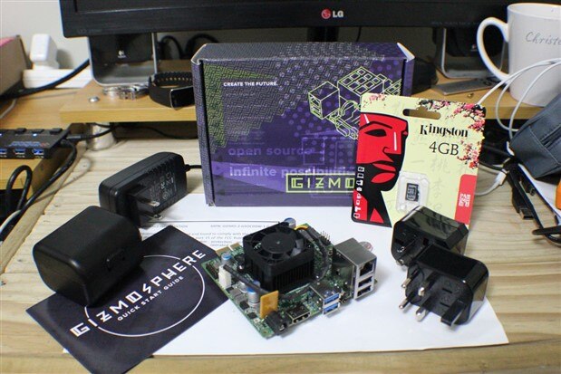

Upon opening the box, one will find:
- The Gizmo 2 Single Board Computer inside the anti-static bag
- A Kensington 4GB microSD card preloaded with Timesys Embedded Linux Demo
- 12V DC travel adapter
- and a Quick Start Guide

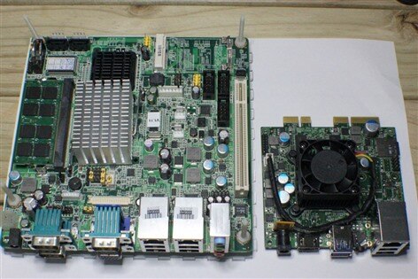

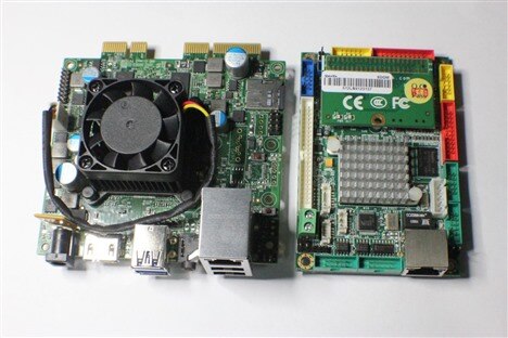

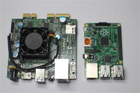

The Gizmo 2 board measures 10cmx10cm (or approximately 4inx4in), almost twice the size of Raspberry Pi and about a quarter of Advantech mini-ITX x86-based board I have lying around.
Comparing the Gizmo 2 board with another x86 SBC, Vortex Tiny SBC Module VDX-6318, the Gizmo 2 board is relatively larger as can be seen in the picture below.

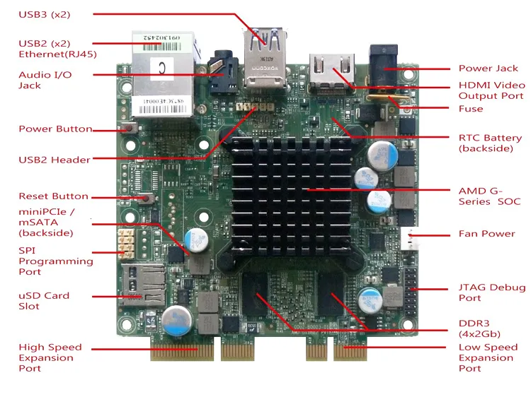

For the peripherals, the Gizmo 2 is packed with modern connectivity ports:
image.php?id=0x2014&image=amd_gizmo2_linux
Physical PCIe 36-pin and x4 edge connectors standout between the boards presented above.  These edge connectors provide direct access to the embedded peripherals of the board, i.e. GPIO, ADC/DAC, PWM, SPI, (more) USB, I2C, display port, PCIe, and SATA.  By designing a daughter board, the Gizmo's functionality can be extended to meet other application requirements.  Some of the examples that I can think of is by the creation of a daughter board with SATA connector, the Gizmo board can be used to build a NAS server.  Another would be to directly interface with sensors and read sensor values via ADC, or connect to other RF modules such as ZigBee through the SPI lines, etc.  With this capability, it actually makes it possible to create a product application utilising low-level peripherals without the need for an extra MCU.

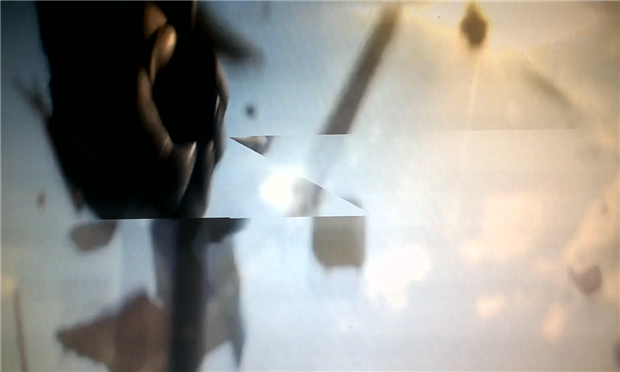

XBMC is... well XBMC and it can only be experienced fully if the system is connected to the Internet (at least initially) so it can be configured and can be used to stream online channels.  All being good and being used to XBMC, I added more videos to test and so I stuck one movie in a USB flash drive and added that to the play list.  The movie did play just fine except when it requires to refresh fast, triangles used in rendering the video can be noticed.

    xever over 11 years ago in reply to shabaz +1
    Thanks for the info Shabaz. It really just happens during fast scenes that seemed to do a lot of rendering. Am about to test it on an UHDTV and visibly check if it is any worse. If so, then as a work around…
