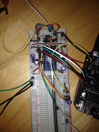

    e14 Contributor over 12 years ago in reply to e14 Contributor +2
    Current test rig. BBB ($45), cs4271 on breadboard (about $15 parts and dozens of hours of labor), Cary Audio SE-1 amp (about $1K), pair of B&W DM302 speakers (about $200). I assembled this system that…

    shabaz over 12 years ago in reply to e14 Contributor
    Hi John,
    120 degree F(48 degrees Celsius) is possibly about right for that IC (half a watt would be noticeable heat from a TSSOP device).
    Regarding sound issues, as you say, perhaps breadboard and power supply may be causing issues with the CS4271.
    For the dac_output.zip recording (different IC, very different use-case but perhaps it helps as some vague reference) attached to the post, this was my (bad) layout:
    5V PSU (switchmode brick)--->BBB playing MP3 file--->DAC-->headphone amp-->Analog line input on PC sound card-->Record to MP3 (dac_output.mp3).
    This is default 16-bit 48k (at least on the ancient Angstrom build I'm got on my BBB) btw, and probably needs driver configuration or maybe modification to change to different settings.
    By the way, one thing to be wary about (I couldn't see it on the photo) is that you may need an inverter on the bitclock until someone corrects it in the driver (maybe this is already the case, but I'm not sure - not downloaded a recent build in a while). It is discussed in some comments above for the detail.
    e14 Contributor over 12 years ago in reply to shabaz
    Yes indeed. I now have a little working prototype using a CS4271 chip (Cirrus) and I'm using the master clock signal from P9.25. Here's a pic of the prototype:
    The metal rod coming from a lump of clay on top of the cs4271 is a thermometer probe, which indicates the chip temperature is about 120 deg. F. I'm surprised it runs that hot. According to the spec, it takes a max of 1/2 watt of power. Maybe 1/2 a watt is enough to heat up this tiny chip. Or maybe I've damaged the chip with my clumsy soldering technique--need to measure what the current draw actually is.  The circuit diagram is essentially the one shown in the PDF for the codec chip (http://www.cirrus.com/en/pubs/proDatasheet/CS4271_F1.pdf). The small chip on the left is an OPA2134 audio op amp.
    The sound quality is quite good. I hooked up the cs4271 output to my hifi and listened carefully to some music, then listened to the same song played directly from the digital source file on the hifi system. There was a little bit of background grunginess from the cs4271 that was absent in the direct digitial playback. This could only be heard on the quietest passages. I expect this is the result of taking power directly off the Beaglebone header pins (a good separate power supply for the analog part of the chip should fix this), as well as the rather poor layout on a proto board instead of a proper printed circuit with a good ground plane.
    Next step is to write a .dts that uses the cs4271 codec driver instead of piggybacking off the HDMI audio device, and hook up the I2C interface. At present I've strapped the chip to be in stand-alone mode, which hides much of the capabilities.
