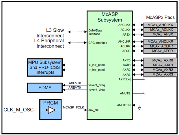

    Hi! Good news, the tech ref manual and schematic reveals some really great things. Lots of copy/pasting of diagrams here to summarize things (since it is hard to keep paging up/down through the 4000 pages):
    This is the block diagram of the MCASP subsystem, which is used for the audio functionality. Specifically, we're interested in MCASP0. This diag doesn't show a lot, but does highlight that it could be controlled via PRU if there was any need to do so, and that it has 4 stereo outputs (AXR0..3), so home cinema type applications are a definite possibility. In fact it seems superb for digital audio. Also, if desired, it can be programmed for direct S/PDIF (section 22.3.3.2 in the document), it doesn't need to be I2S.

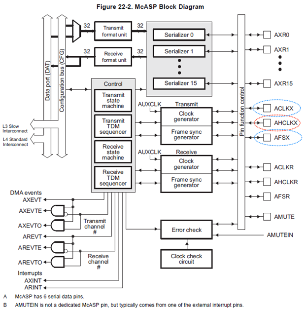

    This diagram below shows it all in more detail:

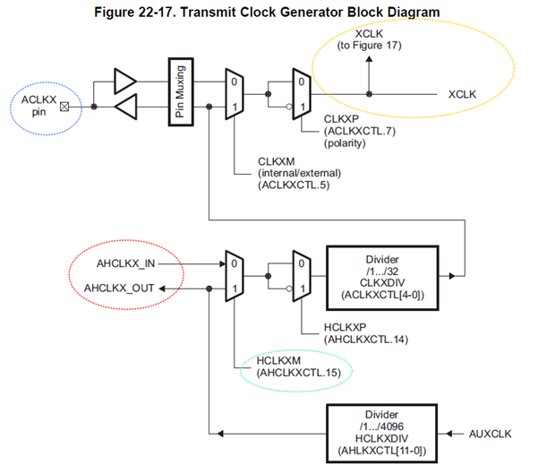

    The blue circled pins in the diagram above are used for the bitclock and the left/right frame clock in I2S mode. Normally these are outputs, but they can be inputs. But, alternatively, there is a pin which can be used for the high-speed clock (e.g. 256 times sample freq) from which the internal logic can be clocked. It is shown in red above, and this can be an input pin. See here:

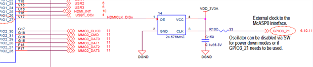

    This high-speed clock pin (MCASP0_AHCLKX) can be seen on the schematic, connected to a wire labelled GPIO3_21 (it goes out to the header P9 pin 25). This is great news, that we have access to the clock!:
    The next bit was the realisation that it is already likely an input pin, since there is already a dedicated oscillator on the board.
    So, the great thing is that we can use this clock (i.e. on GPIO3_21 which is already brought out to a P9 pin 25 as mentioned earlier) for clocking a DAC! The other cool thing is that with no driver mods, it would be possible to also generate an S/PDIF output using a S/PDIF transmitter IC clocked from here too. Of course the driver could be modified to generate S/PDIF anyway (so that no external IC is needed), but personally I'd rather have it as I2S so that the external board could be used for driving a DAC for headphones while simultaneously outputting S/PDIF for external hardware.
    So, to summarize, we can achieve low jitter for a DAC and for S/PDIF transmission (of course the receive side will stilll need to extract the clock so nothing we can do about that) very easily.
    I will try this on my DAC prototype (currently it is using the DAC's internal PLL capability) by connecting to P9 pin 25 and see if it works.
