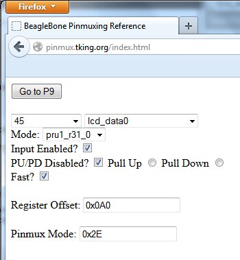

    shabaz over 13 years ago in reply to e14 Contributor
    Hi Eibhlin,
    The first step is to decide which pins are needed by looking at the schematic, I chose the ones that are PRU1_R31_[0..9] because I could see they were brought out to the header. Once you have the header pins details (for example, PRU1_R31_0 is Header 8 pin 45) then you can go to this pinmux site and fill in the details. For example, to set the Header 8 pin 45 to be PRU1_R31_0, it will look like this:
    You can see that it finally gives the 'register offset' value, which is 0x0a. and also a 'pinmux mode' value of 0x2e.
    So, now you know what needs to be configured.
    To configure these values, a .dts file needs to be created. It is called BB-BONE-HSADC-00A0.dts in the zip file.
    You can see that it contains the entry P8.45, and also the pair 0xa0 0x2e further below. You could just edit this file to
    suit your needs.
    Once the file has been created, then it needs to be converted to a .dtbo file; this is done using the make command (check
    inside the Makefile to see the actual command that was used). The .dtbo file is copied into /lib/firmware, and then a command is
    needed each time the BBB is rebooted, to load the .dtbo file. That command is in the script install_hsadc_cape.sh file in the .zip file.
    So, it is a little fiddly the first few times, but you will quickly get used to these steps.
    For more information, see here.
