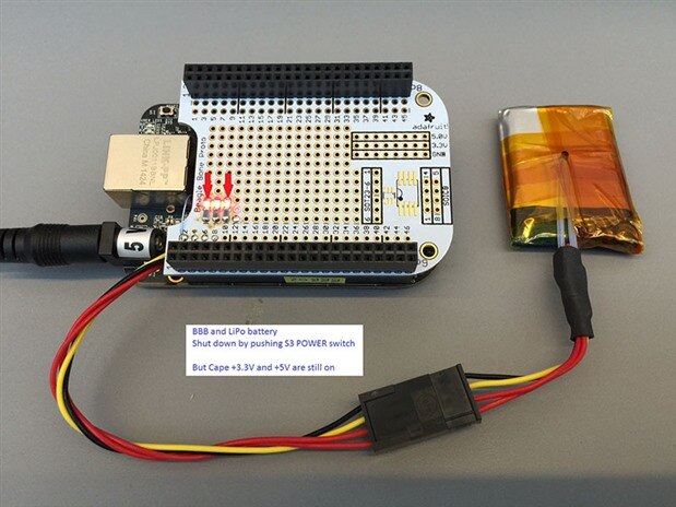

    I want to attach a LiPo battery to a BeagleBone Black Rev C for reliable shutdown.  But when I tried the usual configuration, the battery runs down when the BBB is shut down and the +5V power adapter is unplugged.  It appears that the Cape +3.3V and +5V power does not shut off.
    I added 4 wires from the BBB battery pins (TP5, TP6, TP7, TP8) to a Molex connector, and soldered a 10Kohm resistor between TP7 and TP8.  I wired a 3.7V 1400mAH LiPo battery and a 10Kohm thermistor to the mating Molex connector, and wired it to connect TP5 and TP6 together.  That way I can run with or without the battery attached.
    To monitor the power voltages, I soldered three LEDs and three 1Kohm resistors to an Adafruit proto cape.  The LEDs show Cape +3.3V, Power jack +5V, and Cape +5V.  Like this:
    If I run the BBB with the battery disconnected, then push POWER switch S3 to shut it down, things look OK.  The Cape +3.3V and +5V power shuts off.  This is the desired behavior.
    If I run the BBB with the battery connected, then press POWER switch S3, the BBB shuts down (blue LEDs stop flashing and the blue PWR LED goes off), but the Cape +3.3V and +5V power is still on.  This does not seem right.
    This also happens if I run the BBB just on the battery (no +5V power adapter) and then shut it down.  The Cape +3.3V and +5V power is still on.  This is what I think drains the battery.
    So, finally, my question:
    Why is the Cape +3.3V and +5V power still on when the battery is connected and the BBB is shut down?
    I am running a recent version of Debian Linux.  Perhaps there needs to be a patch applied to the PMIC code?

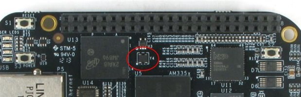

    Got first current measurements from battery without R167: 265uA powered down, about 85mA during shutdown (maybe a bit more - it's pretty brief).
  • pbft
    pbft over 10 years ago in reply to shabaz
    Removed R167 and the LED is now dark on shutdown. Haven't measured current yet. Might be worth mentioning that the LED flickers with R167 in place - not just dim, but flickering.
    It's interesting to me that with R167 in place, the LED will go dark *immediately* as soon as power is applied to the 5V rail on system restart, and that it goes out and stays out if you disconnect and reconnect the battery.
