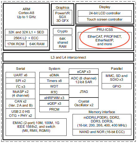

The BeagleBone Black's TI chip (XAM3359AZCZ revision 2) contains the main processor (ARM) along with a number of other modules (see this diagram from the AM335x datasheet).
  Although the ARM Cortex-A8 processor portion of the chip is powerful, the nature of Linux means that real-time control of high-speed external hardware may often still not be easily possible. The TI chip improves the situation by providing two additional CPUs (known as PRU-ICSS or PRUSSv2, I’ll call it PRU for short) on the same silicon. It means that separate software can be run on them, to offload hardware interfacing and processing of low-level protocols.
The chip has been likened to having arduino-type capability on the same chip, but actually the additional CPUs run at a far higher speed (200MHz) which in many cases means that external logic devices, CPLDs or FPGAs may not be necessary.
  Generally, having to program more than one processor is inconvenient and means that a protocol is needed between the processors. This is greatly simplified on the TI chip, because (1) the code for the PRUs can be downloaded from the main processor, and (2) shared memory can be used for communication.

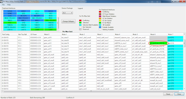

   4. configure the Linux device tree to enable any pins for input/output

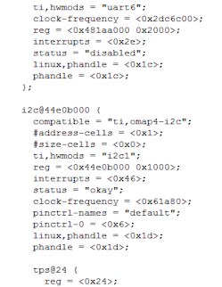

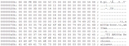

What is the device tree?
See a number of posts (e.g. post 109) here, Selsinork has created some useful examples of it, such as using it to switch off an LED which flashes by default on the BBB.
  The device tree resides in the /boot folder on the BBB, and it is a binary file that is not understandable (example snippet below). It has a .dtb or a .dtbo filename:
There is a program on the BBB called dtc that can be used to convert to a text readable form or vice-versa. Here is a snippet of what the text form looks like (usually a .dts suffix):
Working with the device tree means converting the existing binary .dtb file at /boot into a text source .dts file, making some changes and then converting back into the binary format, and then rebooting the BBB for the changes to take effect.
Here is the procedure to convert the binary file into a text file:
cd /boot
cp am335x-boneblack.dtb am335x-boneblack.dtb_orig
dtc -I dtb -O dts am335x-boneblack.dtb > am335x-boneblack.dts_orig
After any modifications have been made (maybe copy the file first so that you have a backup), it can be converted back into binary form using:
dtc -I dts -O dtb am335x-boneblack.dts_pru > am335x-boneblack.dtb_pru
cp am335x-boneblack.dtb_pru am335x-boneblack.dtb
These commands will be used for a couple of the steps below.

The device tree needs updating to enable the PRUs. Once you have got a text version of am335x-boneblack.dtb (using the method described earlier under "What is the device tree?") then edit it and make the following changes:
Search for pruss@4a300000 and then under it change
status = "disabled";
to
status = "okay";

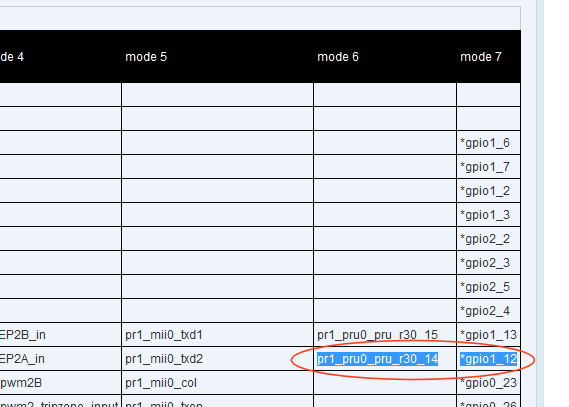

There is one more change for now, but I’ll explain it later. For now, you may wish to make this change too, to run some example code later. If you don’t make the change now, no problem; the device tree can always be updated again at a later date and then the board rebooted.
Search for a line that says
pinctrl-single,pins = <0x54 0x7 0x58 0x17 0x5c 0x7 0x60 0x17>;
and change it to:
pinctrl-single,pins = <0x030 0x06 0x54 0x7 0x58 0x17 0x5c 0x7 0x60 0x17>;
Note: Don't do the pinctrl  modification in recent releases. Just use the .dtbo file method because it works. The information above will be deleted soon, because it does not apply to recent releases.
Save the file, and then convert into the .dtb file as mentioned earlier, and then the board can be rebooted. Now the annoying flashing LED has stopped flashing and can be used for our debug purposes.

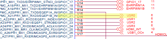

Step 3a: Write the assembler code to run on the PRU
Here I just reused some of the example code (from the PRU_memAccess_DDR_PRUsharedRAM example in Step 2), and modified it so that it flashes the USR0 LED (the LED on the far end of the board).
Here is the entire .p file, I called it prucode.p:

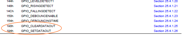

#define GPIO1 0x4804c000
#define GPIO_CLEARDATAOUT 0x190
#define GPIO_SETDATAOUT 0x194

As mentioned, this is derived from the example .p file. The only major difference is around where it says “// test GP output”. All the code before it is an example that shows memory access from the PRU and the ARM processor, as run earlier in Step 2. It is useful since it shows how to communicate between the processors.
The new code is intended to flash the USR0 LED ten times, and here is a description of what the assembler code is doing:
     R0: Used to store a large number for use as a delay
     R1: used to store 10 as a loop counter
     R2: This stores the value 1<<21 which is shorthand for bit 21 set, and all other bits clear. The USR0..3 LEDs are GPIO1_21..24 as can be seen in the schematic (see image below), so if we want to control USR0 then bit 21 gets manipulated
R3: This stores the address of the GPIO1 register which can be found in the am335x tech reference manual (4000 pages) and if you click on the blue text at that location, it goes to the chapter which shows the actual individual register addresses for GPIO1. The code uses this to set or clear the GPIO1 pin 21 in this example.

You can see which pins can be used by looking at Selsinork’s table or by inspecting the schematic. For a test, I decided to toggle a pin on a header as a PRU GPO. I decided to use this pin shown on the schematic, since it is clear it can be configured as a PRU GPO because of the name (it has R30 in it, and is less than or equal to 15).
The quicker way is just to check the table. Hit ctrl-F and search for r30 for example. Then, by looking at column 1 you will see which header and pin the connection is available on. For the pin that I decided to use, PR1_PRU0_PRU_R30_14 is GPIO1-12 which goes to P8 pin 12. In the am3359 datasheet, this PRU pin is called GPMC_AD12 and it needs to be in mode 6 to become an output.

To set the pin to mode 6, I used a utility to help called PinMuxUtility_02_05_02_00.zip available from TI’s website. Once installed, it looks like this:
If you double-click on the signal that you require, it turns green and then you can go to File->Save->SourceFile and it will save two files: mux.h and pinmux.h
In pinmux.h, you will be interested for searching for the text ‘pru’ and it will reveal this line:
MUX_VAL(CONTROL_PADCONF_GPMC_AD12, (IDIS | PD | MODE6 )) /* pr1_pru0_pru_r30[14] */\
So, now you know that to use this signal, you need to set a register to value IDIS | PD | MODE6 and that can be converted to a number using the information in mux.h:

With this information, it is clear that I need to set a register to 0x06. Table 9-10 in the 4000-page tech ref manual reveals the offset that represents the register.
I found this by just doing a text search in the doc for CONF_GPMC_AD12.
According to page 158 of the tech ref manual, the Control Module address begins at 0x44E10000, so ordinarily we need to add the 0x830 offset to it, to get 0x44E10830. However with the Device tree, according to this link when using the device tree the address to use is relative to the base address of the pin gpmc_ad0. That base address is 0x44e10800. So, the number that will be used in the device tree is 0x30.
Remember in Step 1 this change?
was changed to:
The purpose of this was to set the register to 0x06. You can see the register offset ox030, and the value 0x06.
